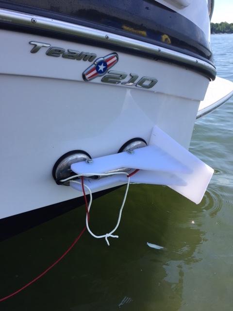

          #169
          Installed on my 2009 210. Used all weekend and was rock solid. I would add the relief holes as water shoots out when you install them.

            #170
            Wakeboyd,
            How are u weighting your boat for surfing? My ghetto looks almost identical to yours and it does improve my surf wave, but the wave still has very little push and I can't let go of the rope. I just can't seem to figure out how to weight the boat to get a great wave with a lot of push.

              #171
              I have been using full factory ballast (Port, Starboard and Center) and a full tank of gas. I can't say it is optimized because I haven't played with it. But it does work for us.

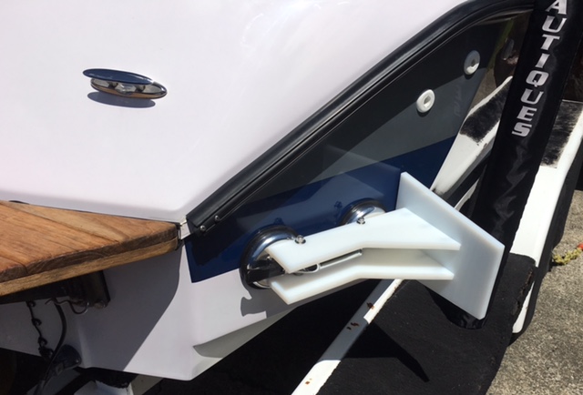

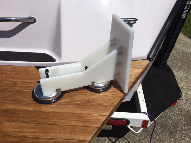

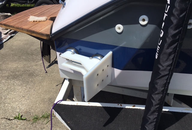

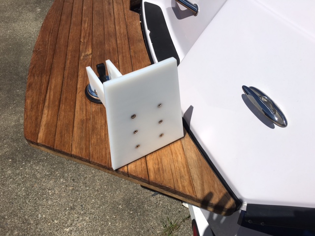

                    #174
                    It rained last weekend here in Seattle so I took a break on my super sport resto build and made up a "suck gate". Thanks to everyone that gave input and a especial shout out to nr2041! I hope to get out and test it out this weekend. I ordered up a kayak paddle tether which should be in tomorrow, total fab cost $37!​​​​​​​
