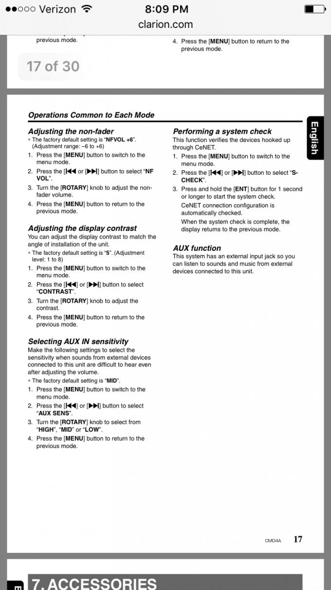

      With that said how is your phone/device getting to your CMD4? Have you checked all the balances and fades from the head unit? Have you checked the NF volume level on the pre outs? Have you checked the AUX sensitivity setting on the head unit? Could also be pair of bad RCA's
      Here is how to check those settings on the head unit

          Thanks Swat. I'll take a look at that, didn't realize that was a thing. I've been using the AUX input as well as an Ipod adapter, they both sound similar. MLA, I should've added that I was thinking of ditching the HU all together. Agree that i've got a problem at the source, so adding something downstream won't help. That KMC20 looks ridiculous.
