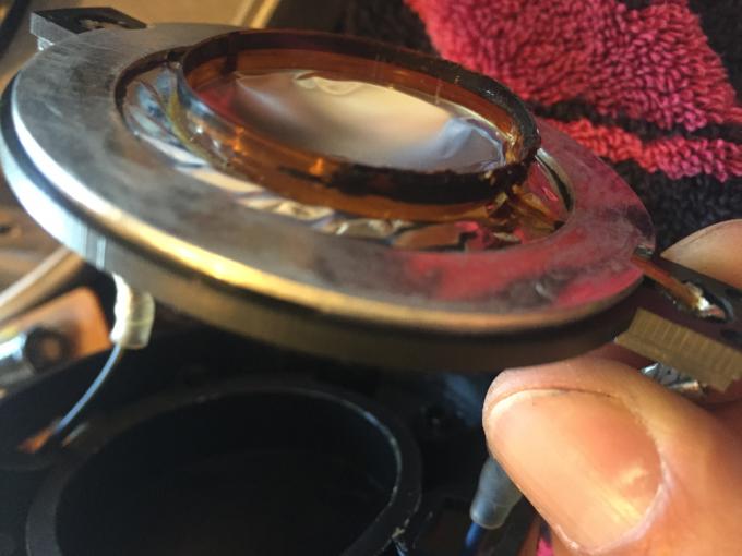

                Okay - all apart - think I found the issue. Appears to be burnt voice coil winding (diaphragm removed - note dark parts on what I assume is voice coil):

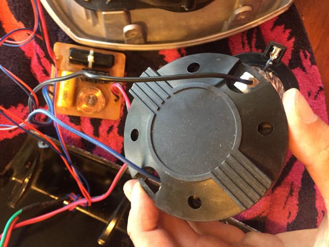

                Here are a couple of other shots of the tweeter driver assembly - Top:

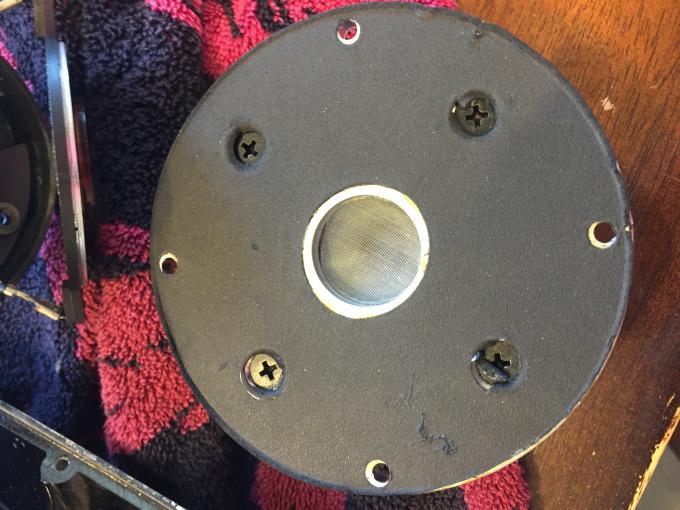

                Bottom:
                As you can see, no part number or markings of any kind. If I measure across the windings, it's exactly 1 3/8" (assuming I measure across the copper windings on the first pic?) If I measure across the diaphragm, it's exactly 1 3/4". The bottom of the driver (last pic) is 4 1/4" - alothough this looks like it may re removable based on the black countersunk screws. I think I may have found a replacement driver here: http://www.ebay.com/itm/P-Audio-BMD-...GkpJX71PhdgxDg
                The only problem with the above driver - It only has three holes on the back for attaching, where as you can see in last picture above, mine has four. Maybe I should just look to replace the diaphragm/voicecoil assembly? Not sure if there would be other damage other than what is pictured in first pic to any other component? Here's where the diaphragm attaches if that helps:

                  Verify that the impedance is the same and that the VC diameter is the same. No point in buying more than the replacement diaphragm/coil.

                      You can't measure AC impedance but you can measure DC resistance. So close enough. The DCR will often measure a bit lower than the nominal impedance. So if you read 7-ohms, that's an 8-ohm voice coil. Reading the bad coil, even if it's not open, isn't likely to be accurate. So measure the DCR of the good tweeter, but across the unplugged tweeter terminals, and without crossover. The DC voltage of the multimeter should be too small to do damage. Just don't take all day. Use the DC resistance mode within the applicable resistance range.
