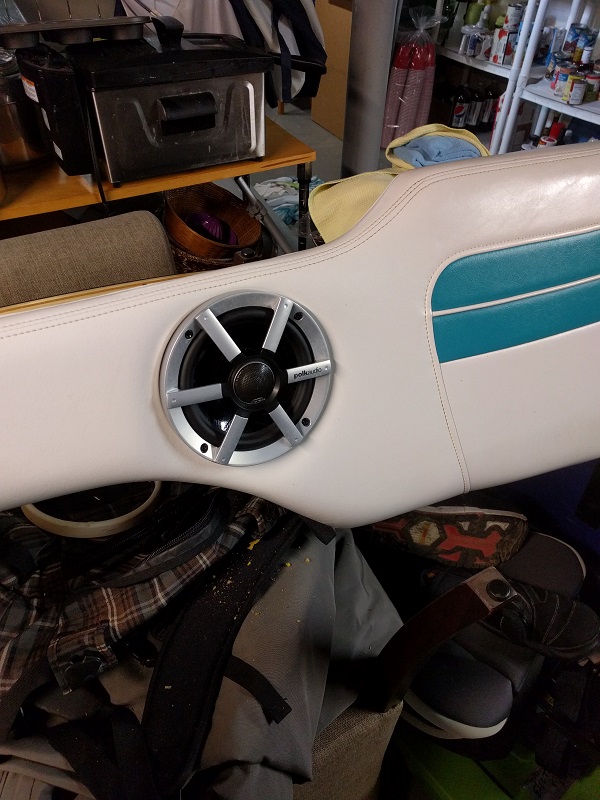

                  So I didn't do a great job documenting installing the MM651, As I had already installed these speaker before I got the request for pics. it's really only the one speaker on the coaming pad as I installed the driver side speaker on the kick panel under the dash. That said this image should give you a good idea of what I did. Click image for larger version
                  In the above image, you will see the black plastic ring is the new plastic space I bought from amazon for $8 per pair.. On the MM651 I used this black spacer to replace the factory white spacer in the photo. The factory spacer doesn't work with the MM651 because it covers the screw holes and is too thin to screw into. The new spacer works great and allows you to mount the MM651 on the front of the coaming pad. The spacer is very close in height to the original spacer.
                  The only difficult parts were fitting the new spacer through the vinyl speaker hole. and making the hole in the foam, behind the vinyl, bigger to fit the wider diameter of the new spacer.
                  I just squeezed the spacer though the hole and pushed the foam out the way till the spacer fit, not the cleanest install but I plan to replace the vinyl next year and I can improve the install then.
                  here are some pics of the installed speaker
                  Front Click image for larger version

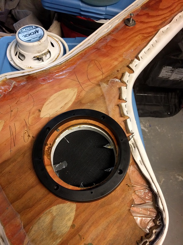

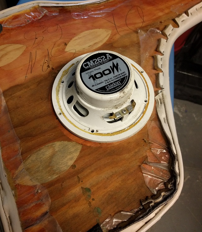

                    I did a much better job documenting what I did the the DB651 which I installed as my back speakers. I installed these behind the coaming pad to keep a factory look and the install overall was much easier this . Click image for larger version
                    Here is the first image of the old speaker in place Click image for larger version

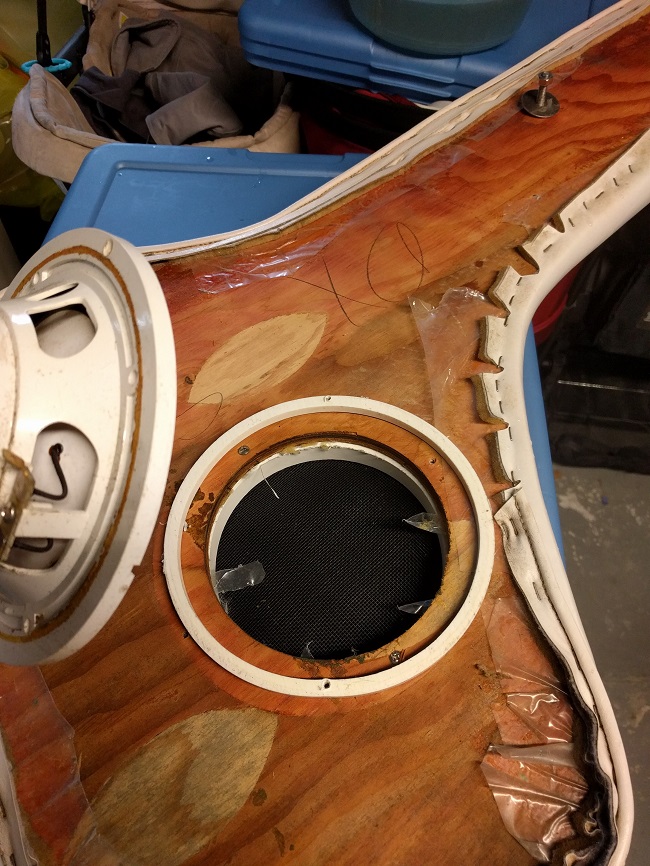

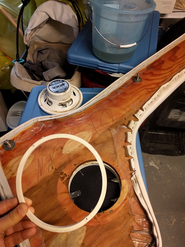

                    This is the speaker removed with the old white plastic spacer in place.
                    Another shot of the factory spacer
                    The new spacer from Amazon. Thi s is the same spacer I used for the MM651s. Click image for larger version

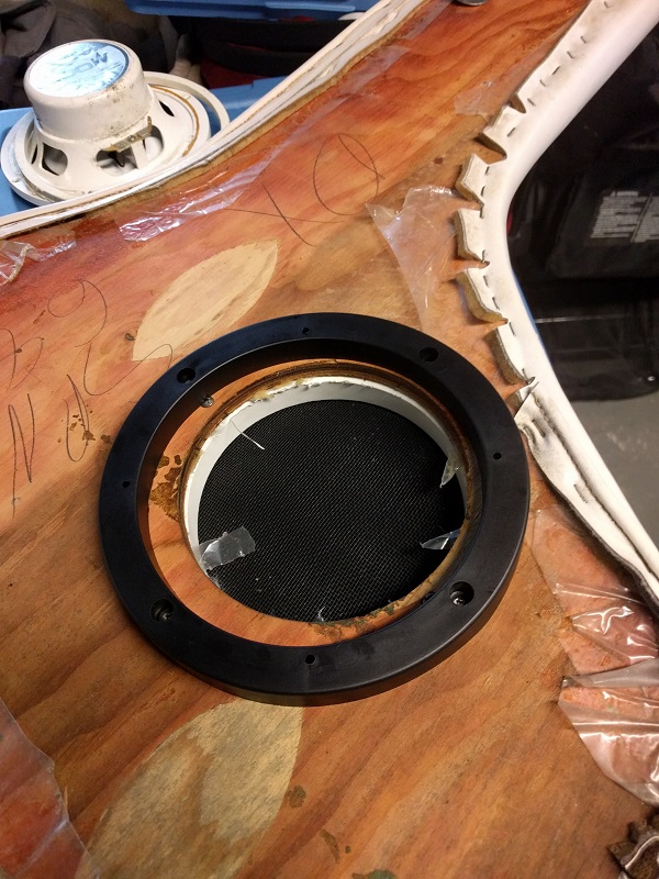

                    Here is the spacer after I screwed it into the coaming pad

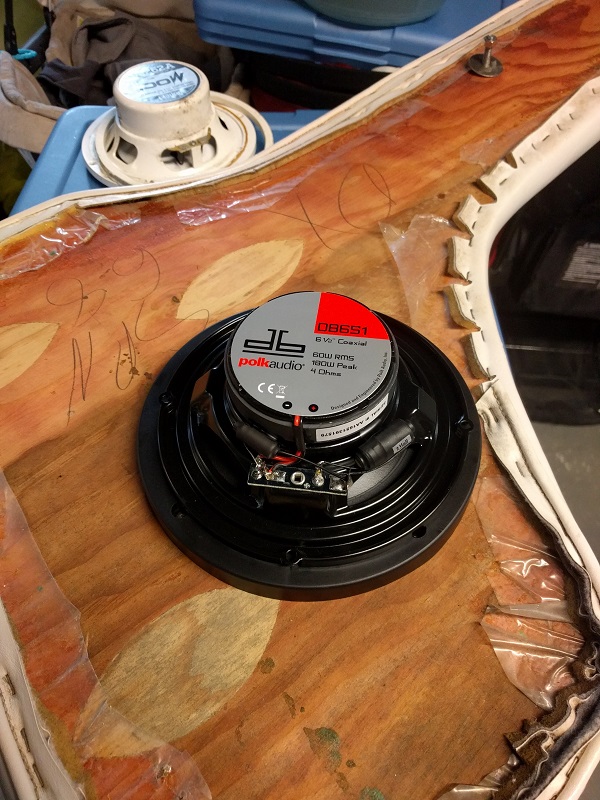

                    And here is the speaker attached to the space. Click image for larger version
                    Here is a comparison of the old vs the new. Very comparable fit and install/ Overall I think the spacers are much better than what was used by the factory. The DBs have about twice the power rating of the factory speakers and should perform much better sine they aren't 22 years old. Click image for larger version

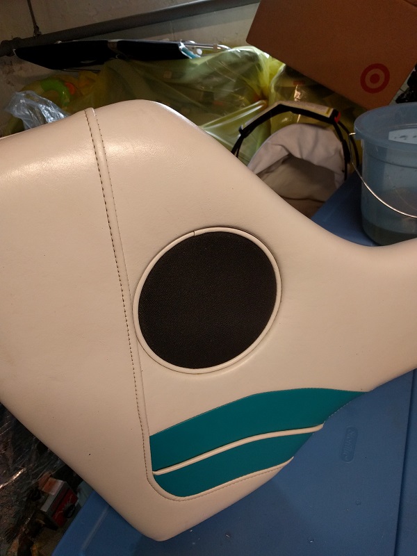

                    And here is what is looks like from the front.
                    Overall I don't think this is the best way to install these speakers, the DB's look like they will be best if they are installed on the front (like what I did with MM) as you can use the supplied rubber ring and get a better fit, but if you want a simple install that will be an upgrade this is a fairly simple and cheap option that can be changed at a later date.
