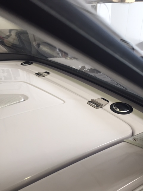

Here is one option...tweeters installed at the base of the windshield...Originally posted by OxDoc View Post
