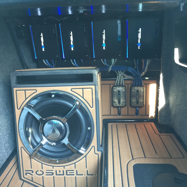

                              Just a couple of things I wanted to point out.
                              First, even though you can't see it, the under-seat storage where the sub lives is indeed vented on 2016+ G-series boats. The vents are under the side pads (above the cupholders). Stick your head in there and look up. You'll see the holes. This was part of JL's requirements when specing their systems for our boats. Going to a larger sub, you might benefit from additional venting though. I am not sure.
                              Second, if you're installing a 12" sub, consider the Roswell sub box, even if you don't get thier sub. It is already the right shape for the floor, and fits very nicely.
