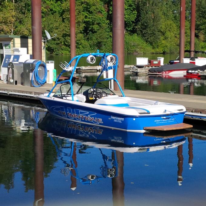

                I've seen some owners mount their speakers above the tower. You could mount the KMT67's in this fashion. Taking a quick look at the tower speakers from JL Audio, Wet Sounds and Kicker, they all have a hang height of around 9 inches. Have you measured the hang height of your current setup? You may be close +/- 1 inch so lowering the bimini may be an option.
