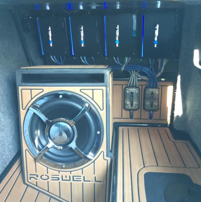

        Here's somebody that did it....and multiple others have done it as well.
        http://www.planetnautique.com/vb5/fo...o-joke-project
        Like somebody else stated (which I haven't seen a G w/o the factory sub), but some G's weren't ordered with the factory sub in which case that entire enclosure isn't even there?? Like I said tho, I personally haven't seen one without the sub there so I'm not too sure.
        Also check the sticky "Let's see em" under this category (link below). There are a few good installs there including some diff upgraded sub ideas. As seen on NautiqueJeff's boat, Roswell even makes a specific box for the G series boats...looses storage space though.

          Have you looked at Roswell's sub box?
          http://www.roswellwakeair.com/produc...-sub-enclosure
          This is what Jeff did with his sub on the PN G23
