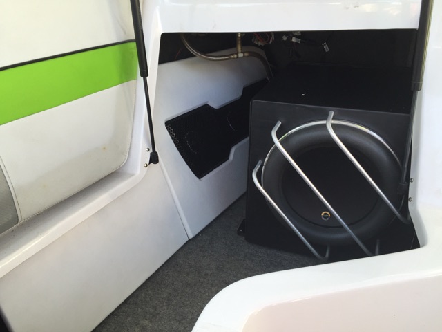

            I have an 08' 210 and my sub sounds crazy good. I did vent the passenger compartment by cutting six 4" holes (4 behind the net and 2 below the seat facing out). I've got a medium to large sized "sealed" box with a JL W6 13.5". I am running a Alpine PDX at only 600watts, but trust me, it is plenty. The low end bass sounds ridiculously good and the 420eq is only up about 30% on sub volume. I previously used a 15" Kicker solobaric in a smaller box, but the JL setup is champ by far.
            I thought about doing your option B and cutting out a big sub hole, but I'm glad I didn't.

                  Not sure if I am going to regret this down the road, but I cut out a similar hole that CC did with the TrashCan/Cooler access compartment. I had some decent gauge metal mesh mounted to the hole and covered by speaker cloth.
                  I have a JL Audio 12W7AE in a ported box, powered by an Wetsounds SD2. Port is firing up (not my first choice). It sounds very good with the seat closed and then kills it with the seat up when beached.
