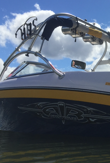

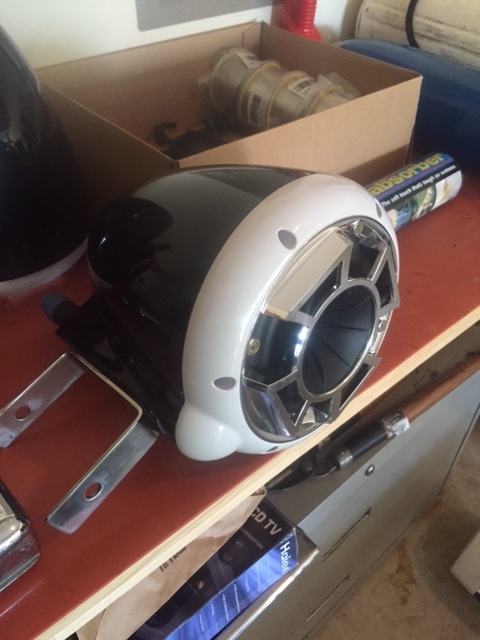

    Fishing speaker wire through the tower
    I'm adding more tower speakers and trying to brainstorm the best way to fish the new wire through my tower. I'm installing WS Pro 60's on the outside of my Air Nautique Duals. Any thoughts? Also, what gauge wire and how much will I need?
