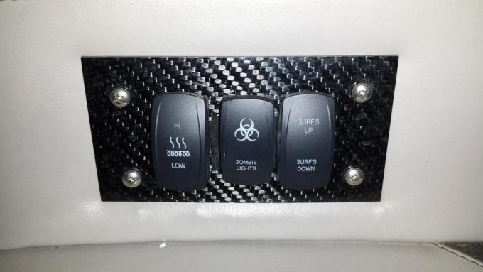

      Or design a switch panel to mount somewhere near the dash. I did that and had some custom switches made. I was real happy with how that turned out.
