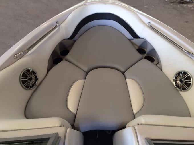

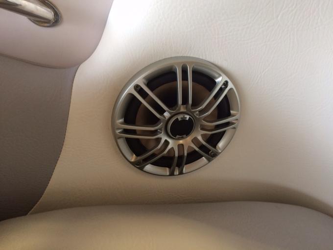

Hi,
for information, just few pics of the stereo upgrade on the 04 210 SANTE i've just bought:
- Clarion CMS2 unit
- Clarion MW1 remote
- Clarion Sub CMQ2512W
- Clarion Amp 5 channel XC6610
- Polk Audio DB651 speakers
It's enough for me but i just want to change the sub enclosure, the original is very bad (not closed)6 Photos
