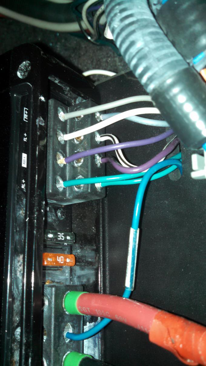

    PS I'm in the boat currently crawling around blindly experimenting- little confused on the wires coming out of the 4 channel... to me it looks like there are 4 speakers being powered by this thing; my assumption was 2 tower + 2 bow speakers. But when I unplugged all the cables going into both amps the 2 bow speakers were still on (the only audio playing) so now I'm assuming they are powered by the headunit after all. Any idea what all these wires off the 4000.4 are for? Click image for larger version

      For what I understand it is for the tower. I just bought a 2013 230 with one set of tower speakers and if you add the second set it is plug and play. The 5 channel is wired to cockpit and sub with head unit powering bow speakers. I was going to go with rev 10 and bridge the factory 4 channel to 400 watts to them but wound up buying a set of factory's from a fellow PN member to get by this season

        From the looks of the wire colors, it looks like all 3 pairs of the in-boats are driven by the 5000.5. This can be confirmed by pulling the RCAs, with it off, then turning it on. If the bows, or any other in-boats, still play, they are not on that amp. I would want all the in-boats on the 5000.5

          Yeah confirmed the 5000.5 is running the 4 cabin and sub.
          So the extra wires from the 4000.4 are running to nothing somewhere up in the tower just in case I want to expand in the future? Can that really be true? Why wouldn't they just leave them next to the amp and bridge the existing towers that came with the boat?

            Yes, id believe it, those wires are for the extra pair of tower speakers. Doesnt mater though, if you plan to move to the Rev-8 and bridge them on the 4000.4, you would want to upgrade the wiring to 12ga.
