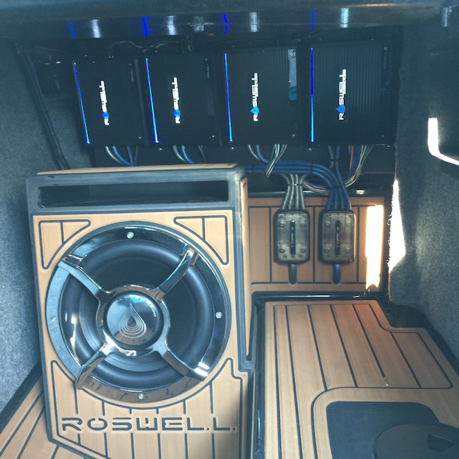

                    Have you looked at the Roswell G-series sub enclosure and the 1211 DVC sub?
                    http://www.roswellwakeair.com/produc...-sub-enclosure
                    http://www.roswellwakeair.com/produc...-dvc-subwoofer
                    Granted it is only a single sub but the enclosure is specifically designed for your G23. Cleanest installation by far. This is from Jeff's PN G23.
