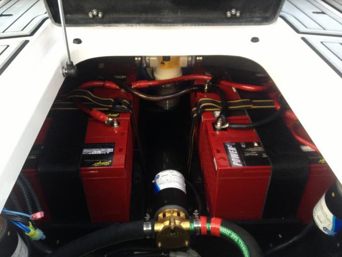

Im always a fan of adding more batteries with upgraded sound systems, I think most are underpowered. IMO there are a lot better places for you to put that battery than next to the trash can. Maybe think about hiding it in the floor compartment. I have tucked 6 stinger batteries in there in my 2013 G.2014 G23 450 Coastal Edition

Can you post a picture of this?Originally posted by nauty220 View PostIm always a fan of adding more batteries with upgraded sound systems, I think most are underpowered. IMO there are a lot better places for you to put that battery than next to the trash can. Maybe think about hiding it in the floor compartment. I have tucked 6 stinger batteries in there in my 2013 G.
