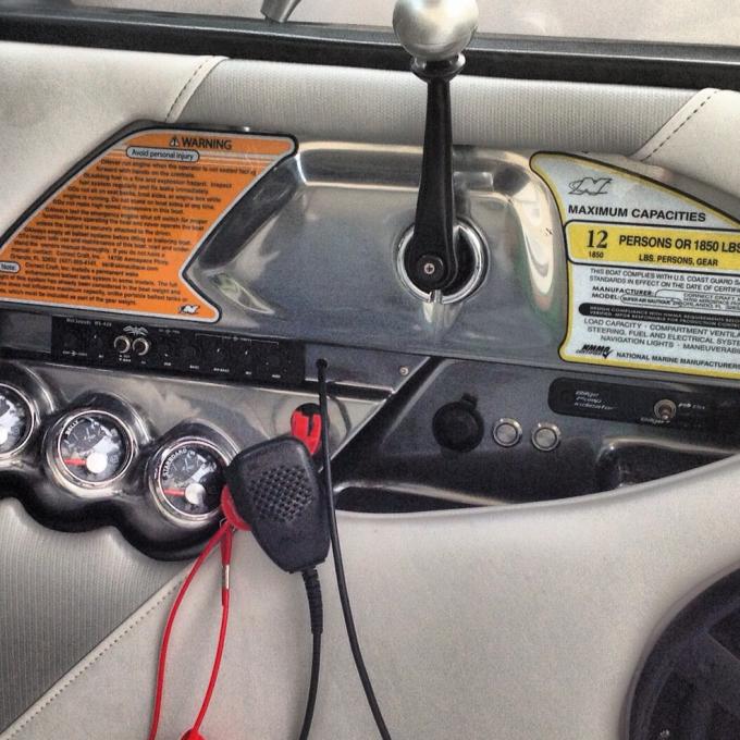

            • RideButter
              • Feb 2011
              • 189
              • Fuquay-Varina, North Carolina, United States
              • 2015 A22 2014 A22 SOLD 2009 210 SOLD 2007 210 SOLD
              Is there room on the 06 for here? I did this on my 2007 and my 2009
              [URL="http://www.ridebutter.com"]http://www.ridebutter.com[/URL]
              • ScooterMcgavin
                • 1551
                • 2014 SAN 210 TE
                Ridebutter
                I never thought about putting it there, but I really like that, I'll check and see if my 06 has the room. Great idea

                • ScooterMcgavin
                  • 1551
                  • 2014 SAN 210 TE
                  I don't believe there is room over there in the 06 it has a little different lay out.
