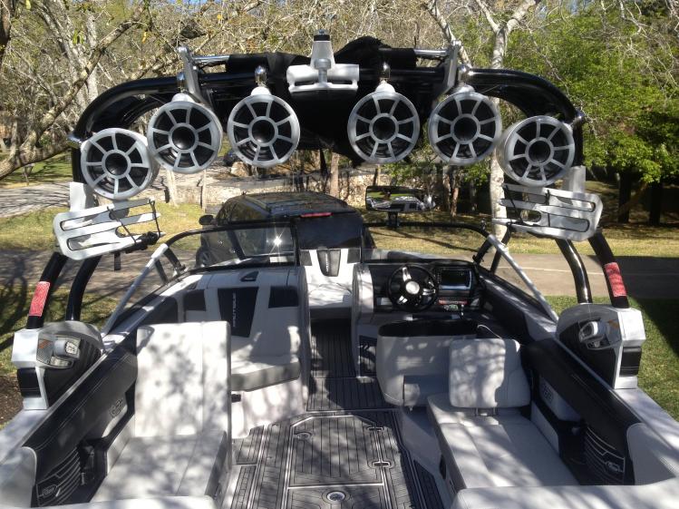

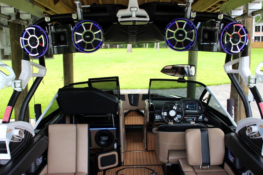

                      Here are pics of my 2013 G23 with three pair. You can see how much room you would have minus the middle pair. The second is my current G showing plenty of room IMO with the 410's

                        Nauty,
                        Would you mind measuring the distance from the bottom of your speakers to the floor?
                        If you had to do it again would you buy the 410s again?

                          I would. The 410's IMO or more a much more balanced sound with more mid bass. Assuming all things equal in power and tuning you give up about 10-15% in volume but you gain more mid bass and in my opinion a higher quality sound.
                          Go listen to them at a local shop. Everyone seems to be moving away from the rev 410 because of size and cosmetics. With swivel clamps we were able to tuck mine to the sides and I like the look.
                          Bottom line they both are awesome. I push a lot of power and tune thru a digital processor which makes little differences more apparent.

                            Those 410's look really sweet up there. They snug up to the corners perfectly.

                              Nauty,
                              Are you able to swing your racks all the way in 180 degrees and not the speakers? I'm diggin' them.
