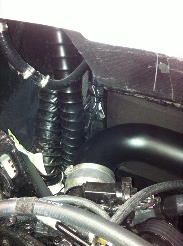

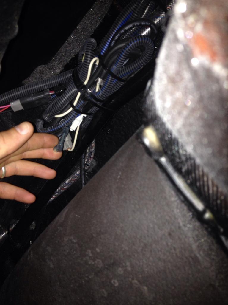

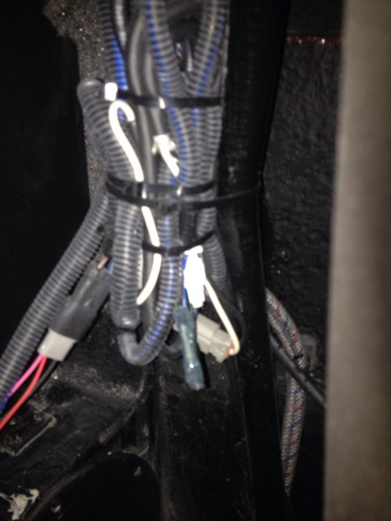

Yep, prewired... There is an unused wire bundle... As you are looking at your engine with the hatch open.... To the rear left... Behind the engine, zip tied off to something, towards the back transom wall, starboard side, roughly level with the top of the engine IIRC. Check out the 2014 G wiring schematic, shows it in there also.

pics to follow2019 G23 450
2014 G23 550
2013 G23 450
2011 Malibu Wakesetter 247
2007 Yamaha AR210
