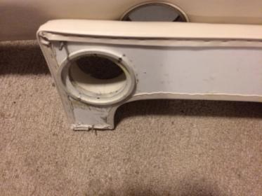

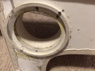

    Take the panels off and the speakers should be accessible from the back side. If you look behind, there are bolts that hold the panel on.

      I just had mine off for new skins recently. Here are some pics that will give you an idea of what is back there. I want to say they are 5/16s nuts but I can't remember for sure.

          To the OP: Most people cut the cloth in an x pattern and front load the speakers.
