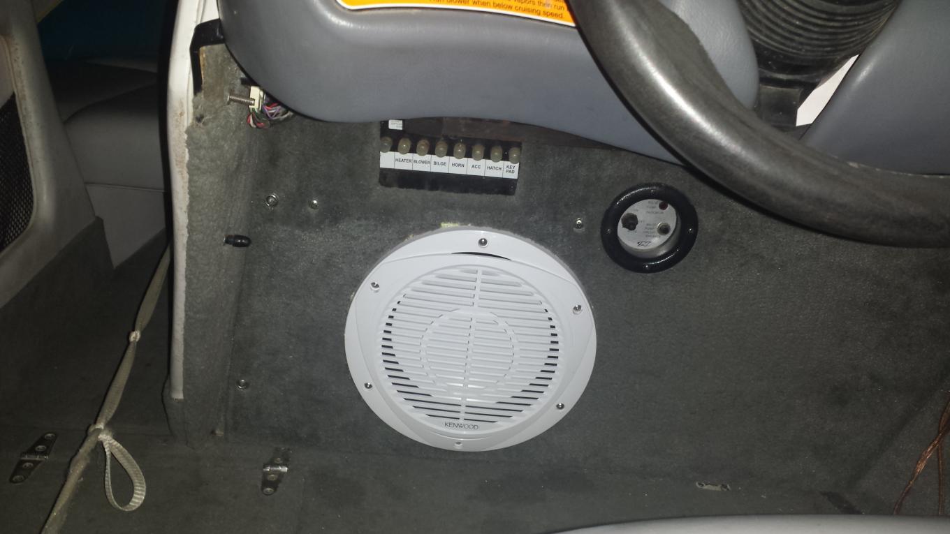

                  Ken
                  2001 DD Air GT40

                    Looks good!
