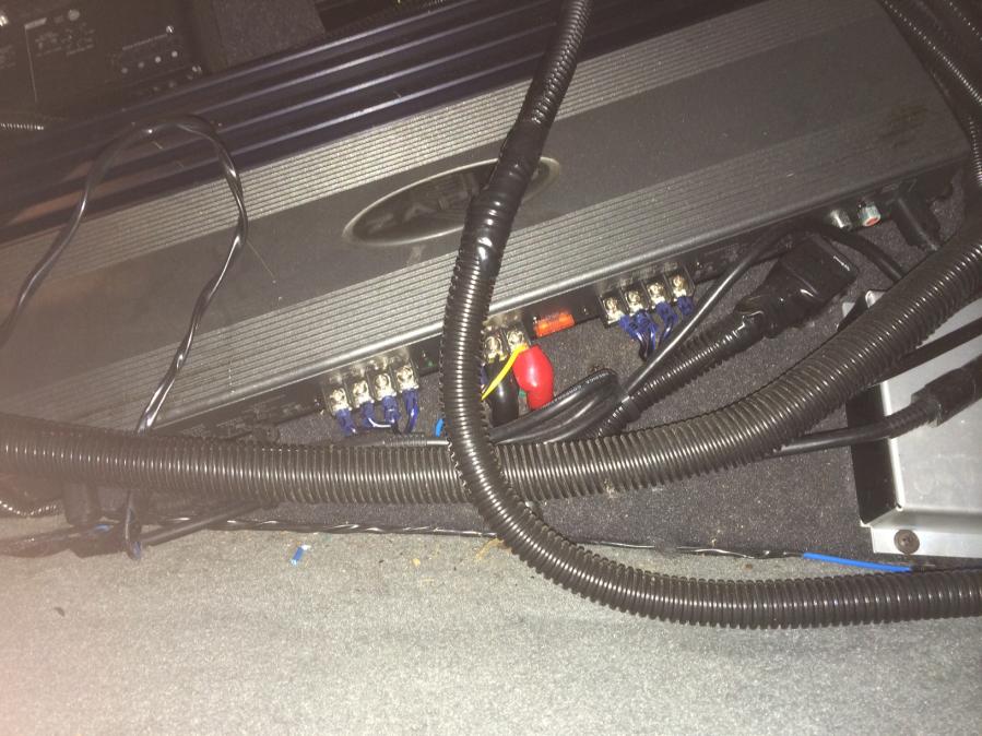

    Is this setup any good?

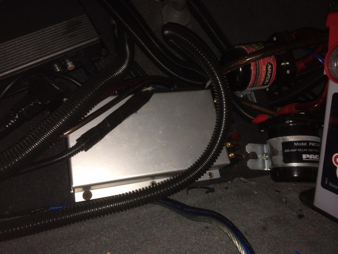

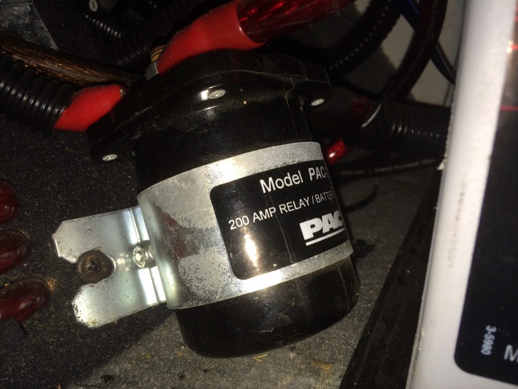

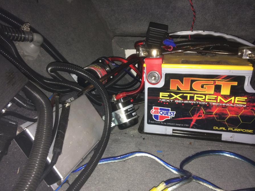

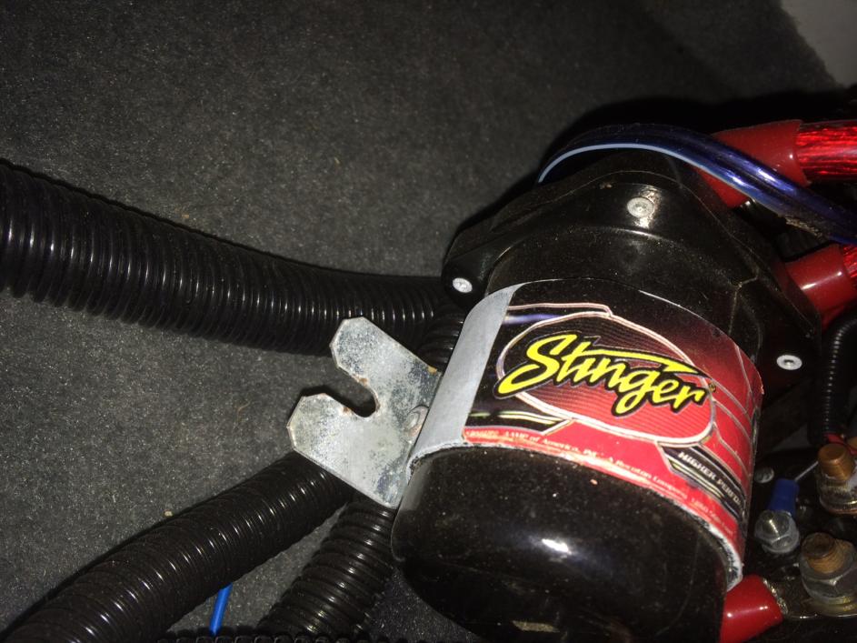

    I bought this boat a few years ago and never really had a reason to dig into the stereo system installed. It worked and sounded good. The other day, I was working on something else and my curiocity got the best of me, so I pulled the sub enclosure out and this is what I found. I know very little about audio. My main questions are: 1. Are the large 200 amp relays better than a perko switch? 2. Why are there two of them? 3. What is the small silver box (picture 2)? It has 2 large gauge power and 2 large grounds going into it and I think it says something like "Aluminator" on the end of it.
    So, is this a decent set up, or should I be looking to switch to a perko style switch? Comments overall about the system? Not shown is a Zapco 200.2 that I believe is running the tower speakers.

    "1. Are the large 200 amp relays better than a perko switch?"
    IMO, no. I like a dual-bank manual switch for the ability to use the house bank as a backup cranking battery.
    "Why are there two of them?"
    Cant imagine why.
    "What is the small silver box"
    custom/homemade amp????? Capacitor prolly, but hard to tell from the pic, but thats my best guess based on only having battery cables to it.
    "So, is this a decent set up, or should I be looking to switch to a perko style switch? Comments overall about the system? Not shown is a Zapco 200.2 that I believe is running the tower speakers."

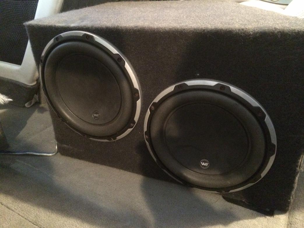

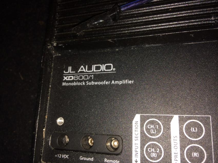

    I would bet that that sub box is un-coated MDF under that carpet. if so, its probably swollen pretty good. Thats makes a sub sound sloppy and muddy. Im not sure, but im thinking that a JL W6 would like to see 600W, not split 600W. So new amp and redo the sub setup.
    If it were me, I would gut the entire system for a rewire, but thats just me. Heres a recent before/after
    Took out a continuous-duty solenoid and made proper use of the factory installed switch and VSR.
    Here is what was eliminated cable wise.

      There is some decent gear there but the install looks pretty shoddy. I agree with MLA, remove all of it, plan the new system, reinstall.

        I agree, it does not look very clean. I probably will not undertake the project of cleaning up wiring for no reason as I can't even see it when the subs are stuffed in there. Maybe someday when something needs replaced. I am still very curious as to why there are 2 isolators/relays.
