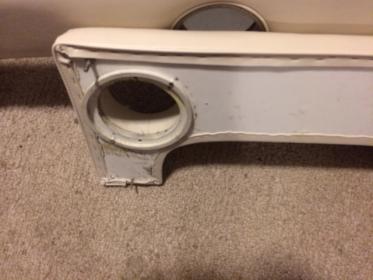

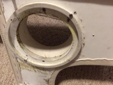

                If your boat is set up the same as a 99 then this is pretty easy. On the backside of the combing pad there are PVC rings held in by 4 screws that the speakers mount to on the backside from the factory. I think those are the speaker mount rings that mike is referring to. Put the baffle on the back of the combing pad and then screw the pvc ring over it. And for the top loading there is a thicker PVC ring on the front of the combing pad under the vinyl. Drill your holes and front mount your speaker onto this PVC ring. I think that is what Mike did, at least that is what I am picturing in my head. My combing pads are off my boat so I can post up a pic later if you want so you can see what the back side looks like.

                      Here are some pics of the back side of the combing pads. I think it's 7/16 nuts that holds them on but I can't remember for sure. The back of the nuts should be a little easier to get at on a direct drive then a v-drive but it's not too bad.

                        ah....picture helps! Thank you!
                        I get it now. I think I will plan to sandwich the baffles between the PVC ring and the pad. Not sure that I want to top mount the speakers (yet). The rings are not glued on right, just screwed?

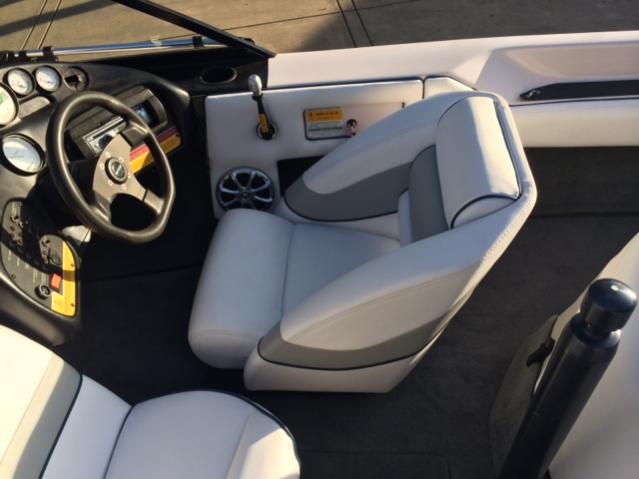

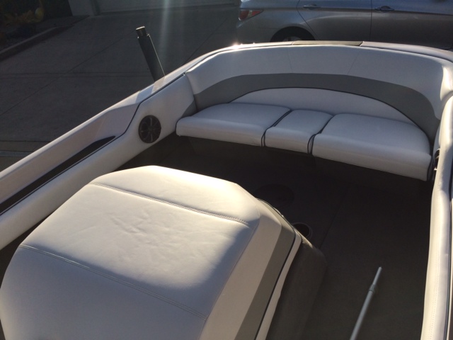

                            OK - did this this weekend. Not a 100% happy job. The PO of the boat had some less than quality work done here that I had to recover from. Here's what did / learned.
                            - my spacing rings behind the combing pad where gone. You need them to fit a 6.5 in speaker; won't flush mount to the pad. Had to make new ones from wood. Size of the rings is key. Must fit tight to the speaker yet be slim enough to fit into the cutouts in the gunnel. Not easy to fabricate rings this size unless you have a really good saw setup and jig.
                            - kept the backmount/cloth set but replaced the grill cloth. Not happy work. The factory did a combo glue/staple to attach the fabric to a plastic front ring that mounts in the pad. It was absolutely impossible to restaple the new fabric into the plastic ring. Incredibly hard stuff. Even with a big pneumatic stapler. To get it to attach, I had to pre-drill four micro holes around the edges and used some mini screws to hold everything in place. Really painful work...
                            - working under the gunnels can give you lots of fiberglass splinters. Not fun.
                            - the foam surrounds work pretty good as baffles. I added in secondary quick disconnects to the wires so you can unplug the speaker wire from outside the baffle.
                            New sound is much better and the new grill cloth looks tidy.
