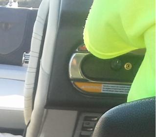

I have mine (should be similar enough to your 230) mounted in the plastic panel where the useless video connector and audio/usb port is without the trim ring. The reason it is so far to the right is because of the depth of the storage compartment that is to the left (door slightly open in pic) and mine is wired into the factory audio connector via a 3.5mm to RCA adapter and a couple of RCA Y adapters so the factory port is still operational even if it is never used.
