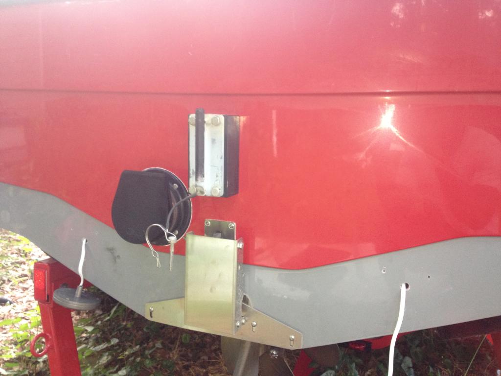

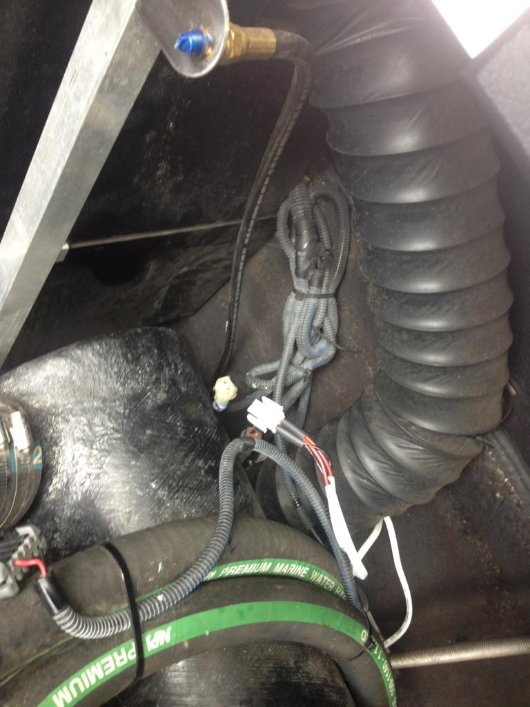

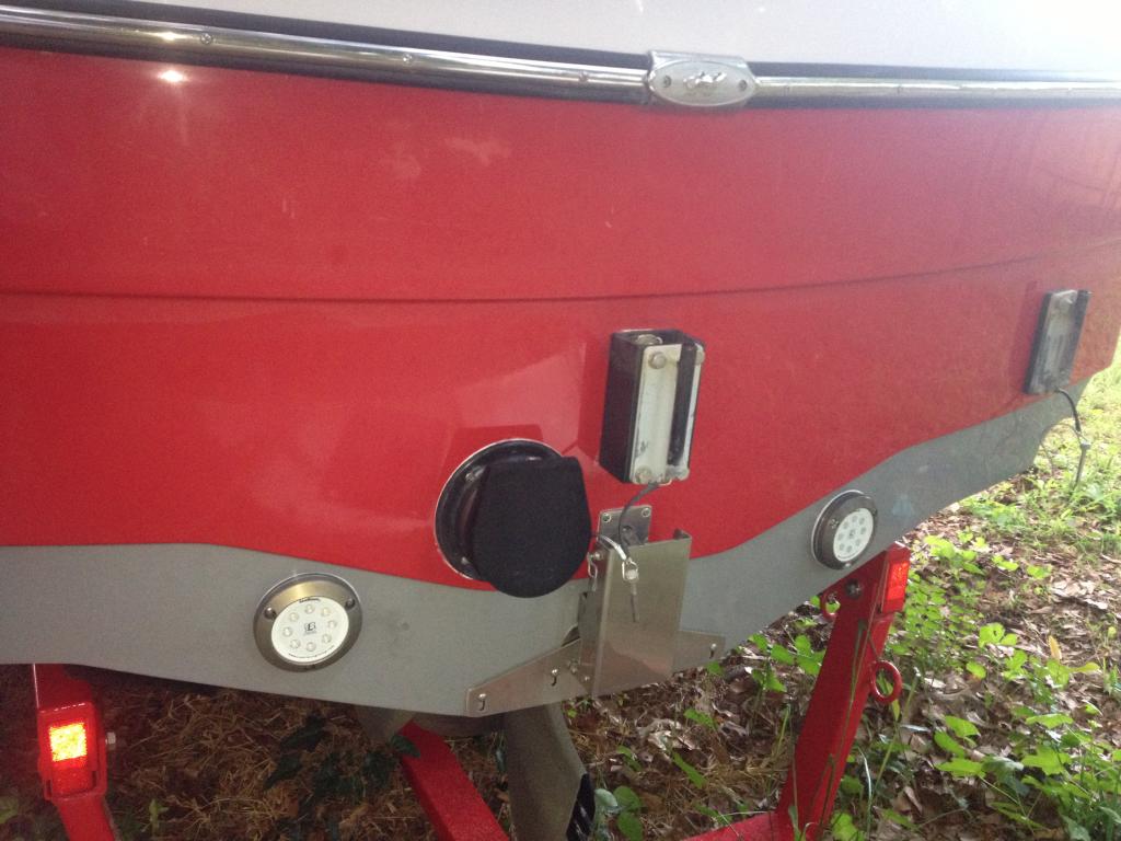

            Updates
            I installed the lumitecs. I tried them out last Saturday at the Fullmoon party. They are RAD.
            The lights are installled using the OEM switch that controls the anchor lights. It took a while an several phone calls to find the OEM male plug for the harness but it was worth the wait.

              Silver surf: adding lights to my boat this winter so I started looking at old post and came across yours. My question for you based on the picture from inside it looks like you just plugged into an existing wiring harness? my boat has a switch from the factory for underwater lights so I was assuming I would have to run the wire all the way back here but maybe not... Would be much easier if I have an existing wire at the back to plug into.
              2010 SANTE 230 RZ409
              • Silver Surf
                • Sep 2013
                • 68
                • Smyrna
                • 2006 SANTE
                Yes, the female plug was there. I had to put a male plug on the lights
