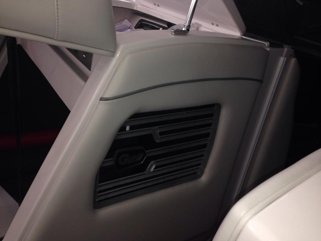

While not a 230, this does illustrate the vents that are required to allow the bass radiation to flow from the locker.
http://www.earmarkcaraudio.com/insta...irNautique.asp
The more surface area a vent has the better it will sound.
