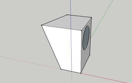

I have taken some measurements and made a cardboard model to fit the factory space in a 210 and plan on making this shape from fibreglass with MDF for added strength.
This design has a total volume of 46L (1.6CuF) and minus driver volume and wall thickness we'll call it 42L (1.5CuF) and i will use an external port. Obviously I will measure the volume exactly once it's made and then tune the port to suit, but this is a start.

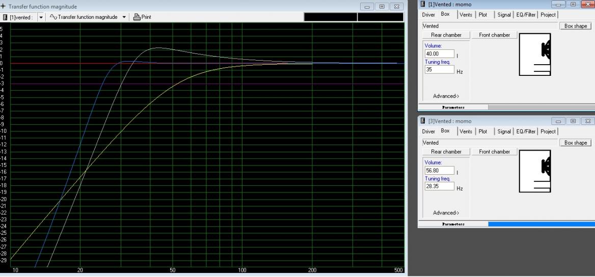

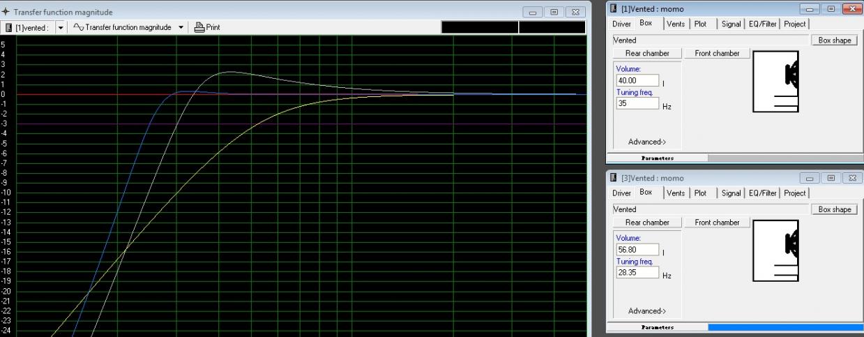

Here is a screenshot of 3 scenarios.
Yellow: sealed enclosure, No doubt similar to what I am experiencing now with the factory enclosure.
Blue: What winISD believes to be the ideal setup, however uses a 57L (2CuF) box which I cannot squeeze in.
White: What I believe could be a good compromise trying to get some output from this little 10.
I read a number of people have tuned their box to 40hz because not much below this is audible in an open environment like a boat, however seems to create a very sharp peak.
I figured 35hz might be a good compromise?
Any thoughts?
Also any thoughts in port direction etc welcome.
