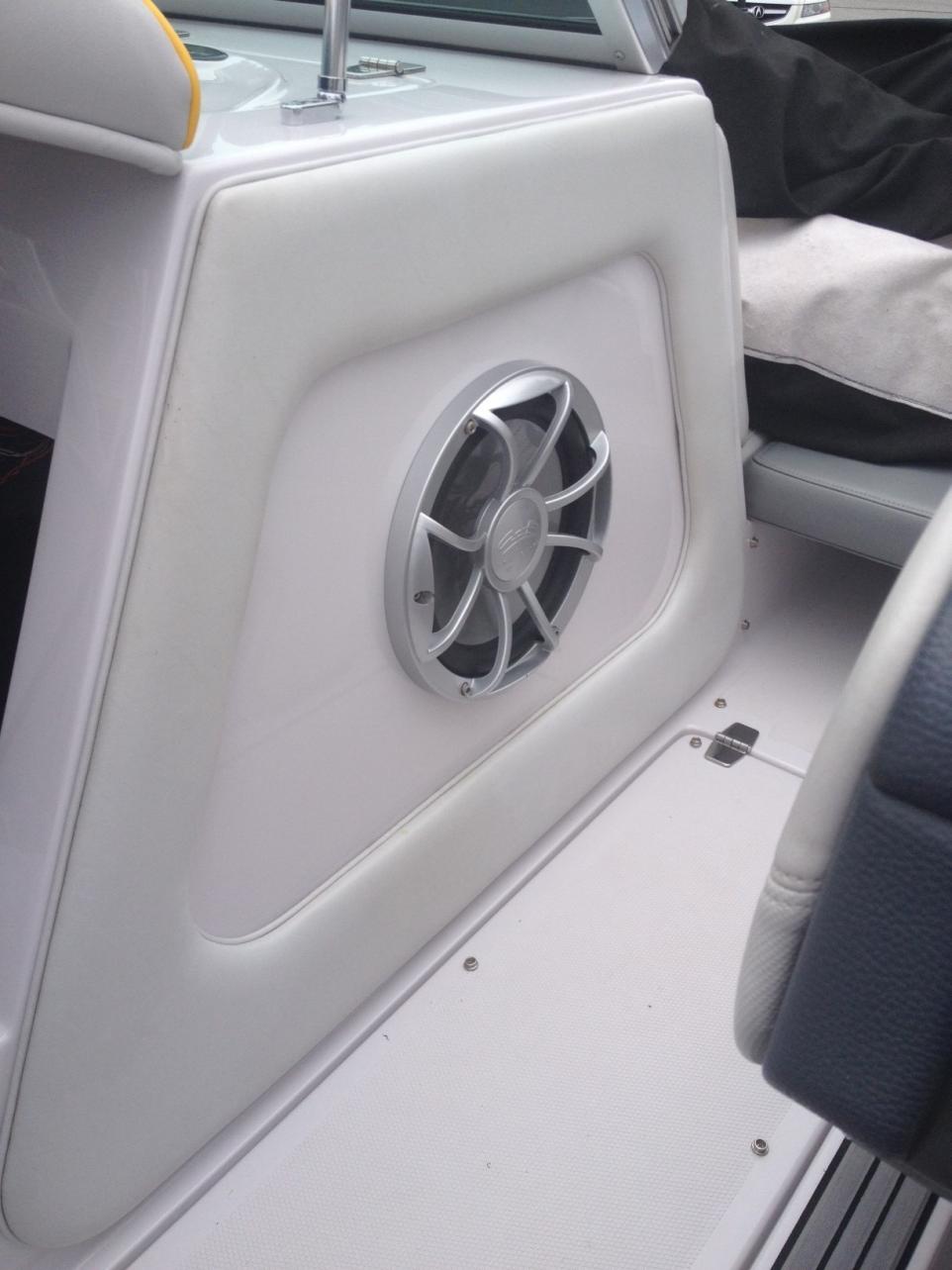

    Cutting the hole was a little nerve racking, but like I said. Can always add a cooler door later.

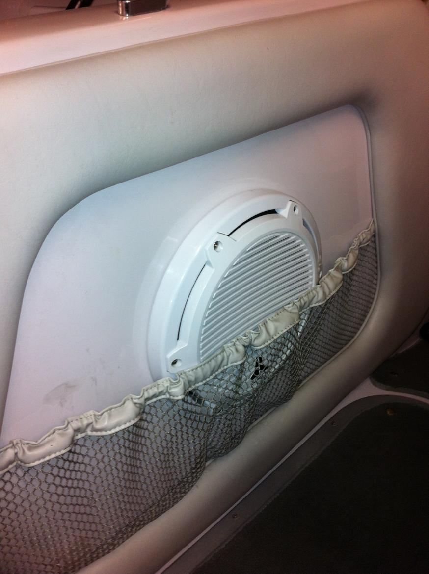

      I have a small soft sided cooler that I put in the floor/ ski locker. My space gets taken up by dry towels etc. I am almost convinced that I am going to cut the console out for a new JL Audio M10IB5 Sub that a friend is giving me next week.

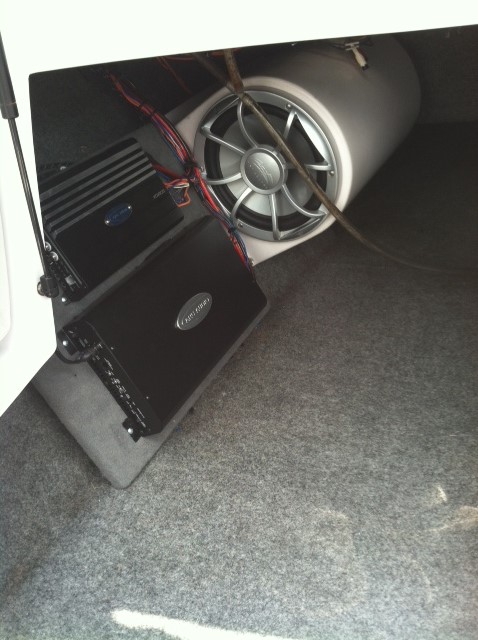

              Now you have a good woofer in bad enclosure and the compartment is not vented to the exterior. No chance of performing.
              An infinite baffle woofer makes a big improvement mostly because it is direct-radiating.
              The next upgrade would be to take the existing SS10 woofer and place it into a bass-reflex enclosure. The compartment would then have a vent cut into the pass-thru surface with an acoustically transparent grill added. This is a larger enclosure than the existing but still leaves considerable storage space.
              The next upgrade would be bass-reflex 12", like a Wetsounds XS-12, with a vent. It's large but gives you the strongest option.
              • David Analog
                • Sep 2013
                • 263
                • Dallas
                #22
                Okay, upon closer inspection I see from the photo you have a Wetsounds XS-10 and not an SS-10.
                The XS10 is a high 'Q' woofer that is optimized for an infinite baffle application so it really should not be in that enclosure. That driver is better suited to install in the pass-thru surface with no enclosure beyond the compartment volume.

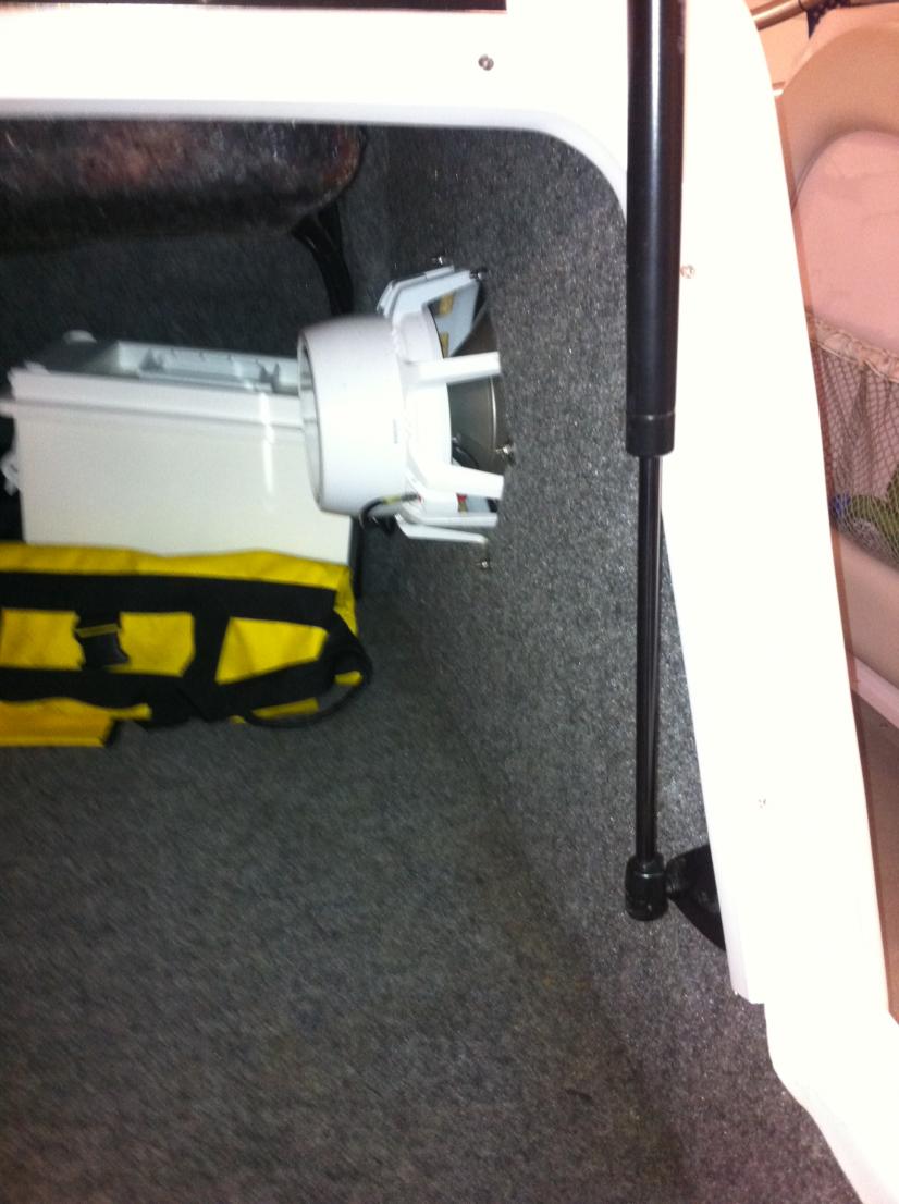

ID:	368085 I used a piece of 3/4" advantech waterproof subfloor to reinforce the panel. I cut it out to fit the back of the panel, cut out for the woofer hole, applied substantial silicone, and through bolted underneath the upholstered panel which was removed and used c-clamps around the woofer hole. I let it cure for 48hrs and mounted the woofer using stainless machine screws. I pulled the factory carpet back and applied spray upholstery glue and reiinstalled the carpet. Very happy with the end result, but cutting that 10" hole was very, very hard emotionally.

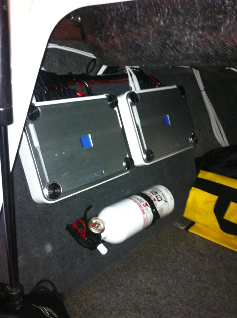

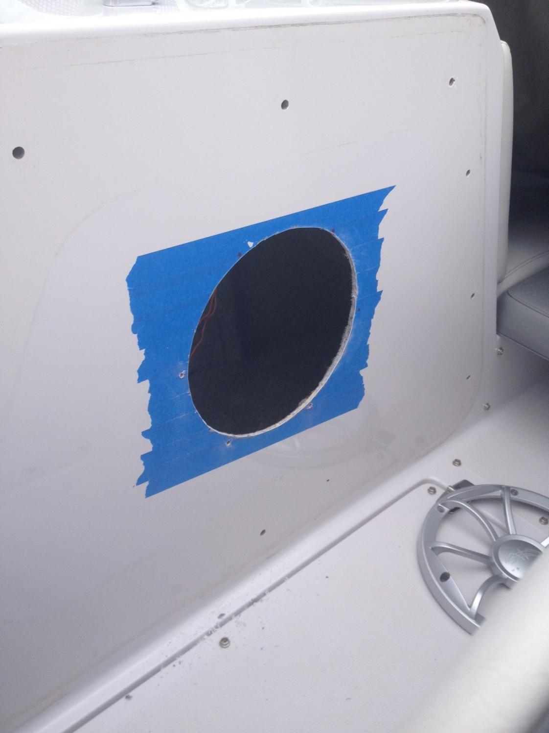

                        Well I finally had the time and mental conviction to cut a large hole out in the side of my port console!! Measured multiple times and only cut once. Making the perfect template for the sub was a critical step. As you can see in the photos I ended up using my existing WS XS10FA which now sounds amazing. I can actually feel it!! I have a few more modifications to do on/ behind the mounting wall as well as adding the carbon fiber vinyl material to the face of the console like RideButter and will post photos when I finish.
