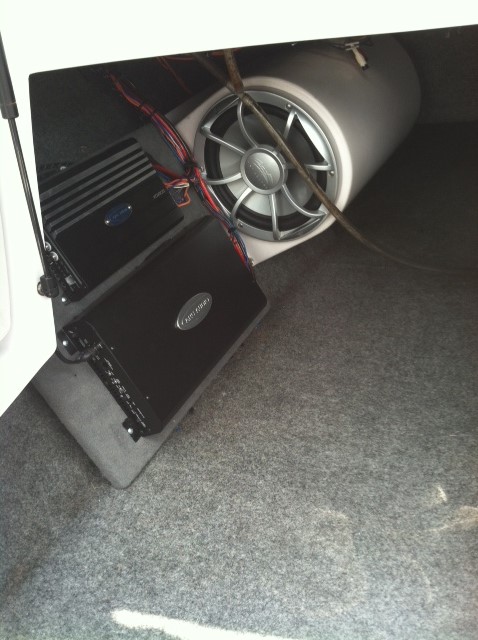

I had an 03 210 and David installed a setup that hammered, I think they referred to the set up as side fire. Meaning it faced the wall and was installed rather close.2014 G23 450 Coastal Edition

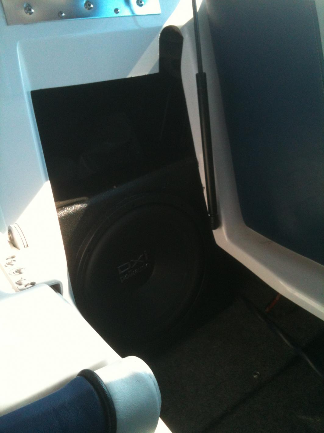

I moved my sub in enclosed box to the back port side which made it somewhat worse but still good sounding. But then I still have room for 1100 lb sac with it back there, and sac under love seat for surfing. so no bags out ever. And frankly when out just going slow or wiping down, I pop up the seat like shown in the picture for extra bass.
http://www.crutchfield.com/S-IusvzDk...ml#details-tab
http://www.alpine-usa.com/product/view/pdx-1600m/
This set up is pretty good power matched so does a lot for the inexpensive sub.Last edited by scottb7; 03-13-2014, 09:44 AM.

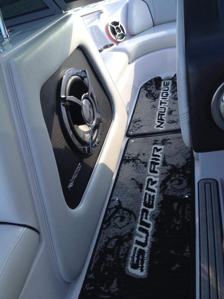

It appears that you have a cover on the back side of the sub. Did you build it?Originally posted by RideButter View Post[ATTACH=CONFIG]27307[/ATTACH] The carbon fiber is just vinyl, I used spray adhesive to attach it to the fiberglass and then added the sub. I figured if the future owner wants it changed someday, you can always just put in a cooler door.2008 210 SANTE
Yeah I built it. Wooden box resin coated inside and out and rhino lined inside and out. I used marine grade adhesive from the box to the wall and then screwed through the fiberglass wall into the box.[URL="http://www.ridebutter.com"]http://www.ridebutter.com[/URL]
