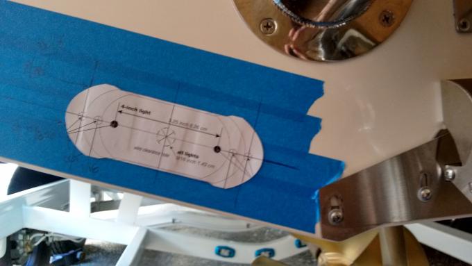

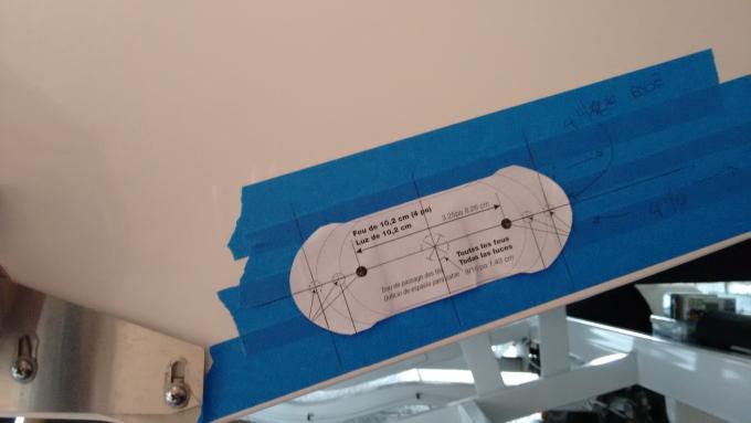

Installation is easy. You just drill a hole for the mounting bolts and wiring to pass through. The boat wiring is already in place. Just hook them up and activate the underwater light feature in the Deaker Settings screen in LINC and you’re all set.
Thanks Jeff. I ended up finding the Attwood Light Armor 12 LED's in stainless, looks to be the factory underwater lights. At 3,500 lumens for the 12's, they come in quite a bit brighter, for a little more money, $250 per side. Trying to keep it as factory as possible. Install should be the same. greatly appreciated.

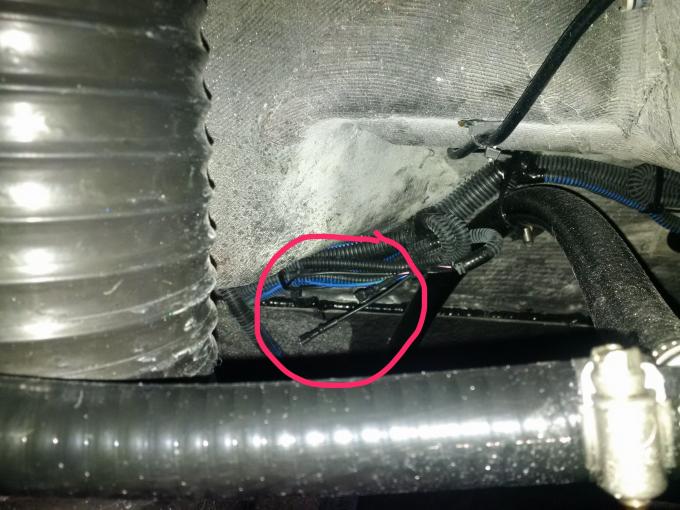

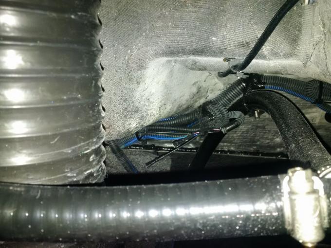

Did the LED's connect to those wires?Originally posted by Randy1833 View Post
Any my idea if the two black wiring connectors in the middle of the photograph are the factory prewired light connectors? The photo shows the rear starboard corner inside the engine compartment.

I’m assuming this is the correct wiring harness. Too much of a coincidence that two sets of wires (two harnesses) are just sitting in the engine compartment with connectors. Any one have any information on programming the “Dealer Settings” to program the lights on my 2017 Linc 2.0? It would be greatly appreciated, Thanks.lLast edited by Randy1833; 06-16-2018, 07:38 AM.
Dealers can typically access "dealer settings" mode.
Blue is illumination, just need to confirm that that blue to activated by the underwater light output once its activated in the link, unless its tagged at the underwater. I would expect there is a 2nd blue/black pair on the other side, rather then one blue/black for 2 lights.
Looking good Randy. Let us know how they finish up and what wiring you used.Originally posted by Randy1833 View PostI’m assuming this is the correct wiring harness. Too much of a coincidence that two sets of wires (two harnesses) are just sitting in the engine compartment with connectors. Any one have any information on programming the “Dealer Settings” to program the lights on my 2017 Linc 2.0? It would be greatly appreciated, Thanks.l

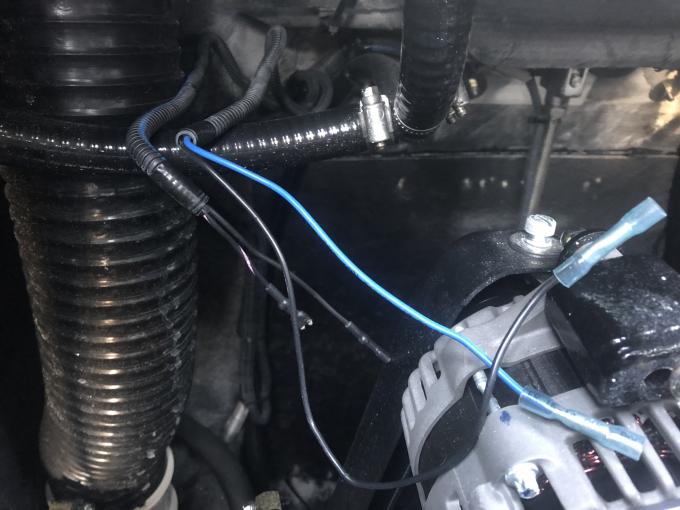

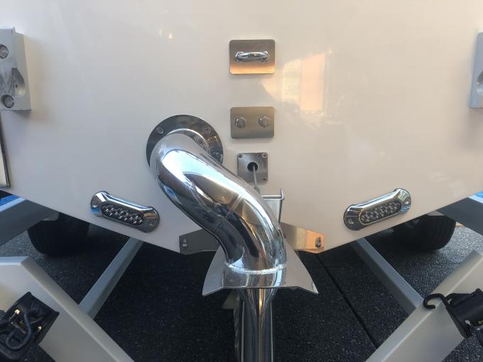

Nautique customer service was nice enough to confirm the wiring for me, black and blue bundle on each side in the engine compartmentment. Programmed it into the LINC 2.0, five minute job, and confirmed it with my voltage meter. Crimp connected the lights, and all done. Final check with a short burst of the new underwater lights. Very pleased with the results.
thanks for the update. Any pics of the wiring you can show us? what all was involved in the programming into the linc?Originally posted by Randy1833 View PostNautique customer service was nice enough to confirm the wiring for me, black and blue bundle on each side in the engine compartmentment. Programmed it into the LINC 2.0, five minute job, and confirmed it with my voltage meter. Crimp connected the lights, and all done. Final check with a short burst of the new underwater lights. Very pleased with the results.
I like the look of everything but was thinking of a different light. Either the Roswell or the Lifeforms.
