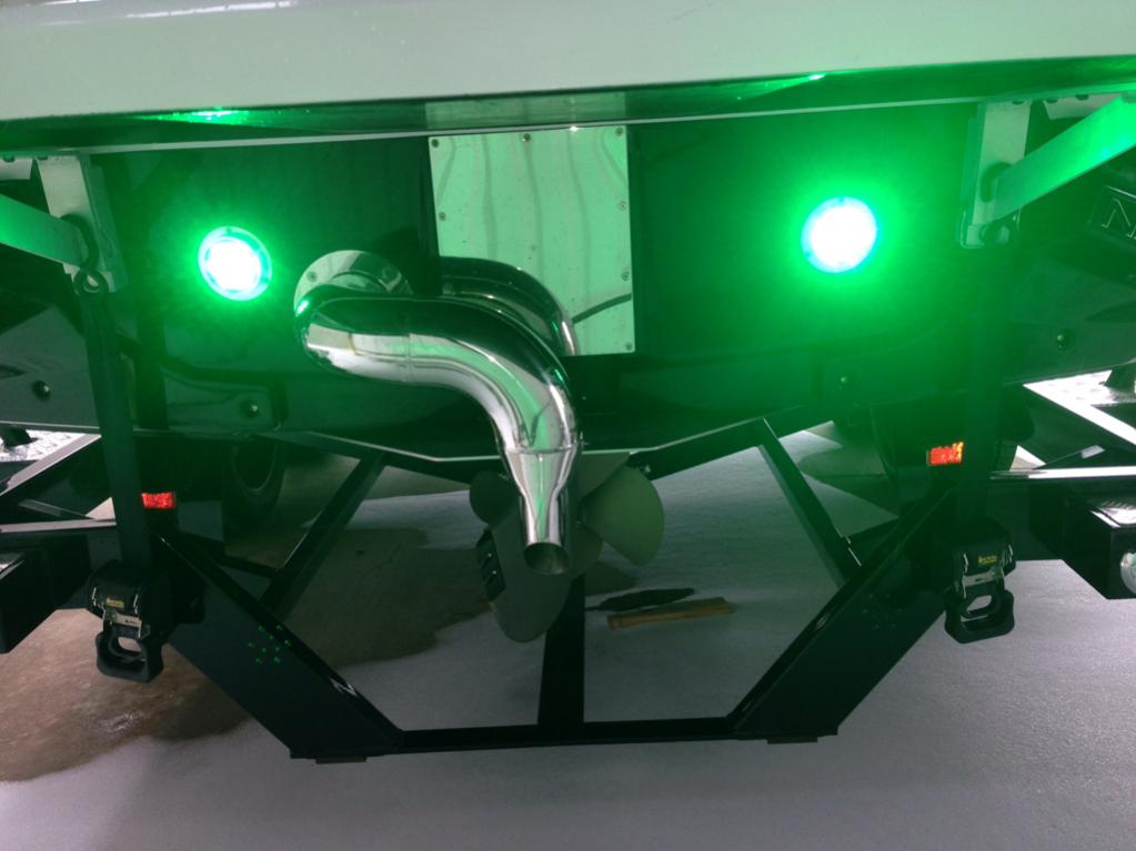

      Just FYI, Lifeform 9s, even at their regular advertised $360 price, are the undisputed best buy in price $ per lumen at 2,637 lumens ea. And often can be had cheaper thru their periodic promo sales... This fall I bought a pair off an add they had on Facebook a while back...I think I paid $310? just had them installed, enabled the OEM feature for control on the Link screen. very sturdy quality product. 2600 lumens is blinding.
      Keep in mind OEM LEDs are around 1000 lumens ea for reference. If a manf doesnt post the tested and spec'd lumens, thats should tell you something, you dont bring a product to market and forget to test it.
      Focus on the price per lumen, and try to get above 2000, aluminum housing, thermal protect... most everything else is just advertising noise.
