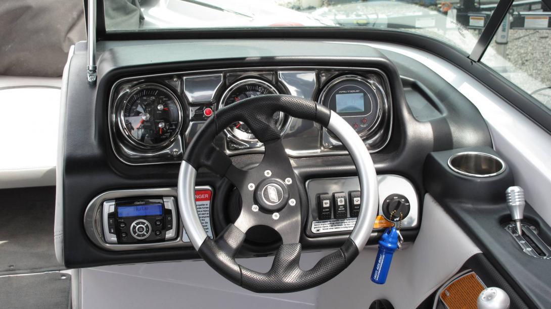

      The current stereo I have attached a picture of. A friend of mine had their CMD7 replaced due to a fault which I have since had repaired so it is an option. Am I better off selling it and keeping the current one?

        The unit in that pic is the Clarion CMS1. Unless you want a CD player, I would not swap to the CDM7.
