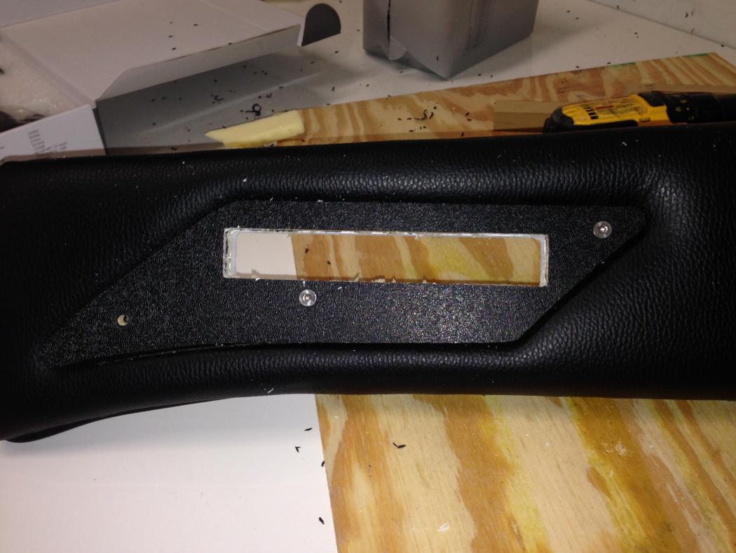

    Can you send a close up photo of the WS 420 mount? Was that custom made?
    here is a face plate custom that my installer sent me Click image for larger version

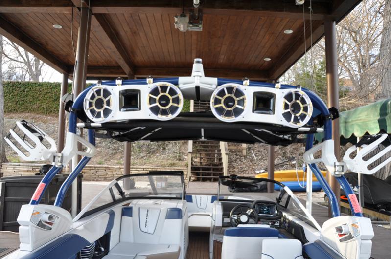

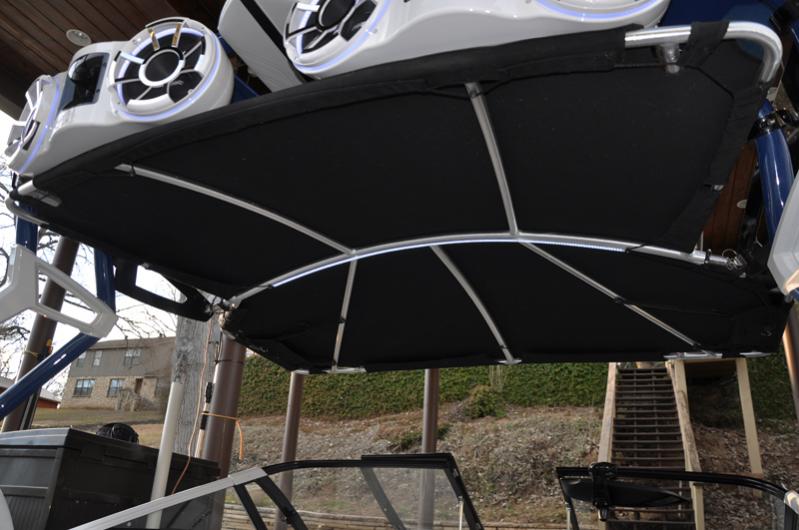

              Here's a couple of shots of the starboard side modifications and XS-XXX slot loaded enclosure installed. Also a couple of the bimini installed. The empty racks close to full and locked position without rubbing.
ID:	368067Click image for larger version
ID:	368068Click image for larger version
ID:	368069Click image for larger version
              One slight correction on the MCC404s - We are running them mono for 600W @ 4 ohms per REV410. ;-)

                If you invert those board racks..... you'll be able to put wakeboards with boots in the top racks. Inverting them will buy you 6-10" of clearance. Still work just as well, they just dont sit with such a high angle on the forks.
                here's what they look like inverted.

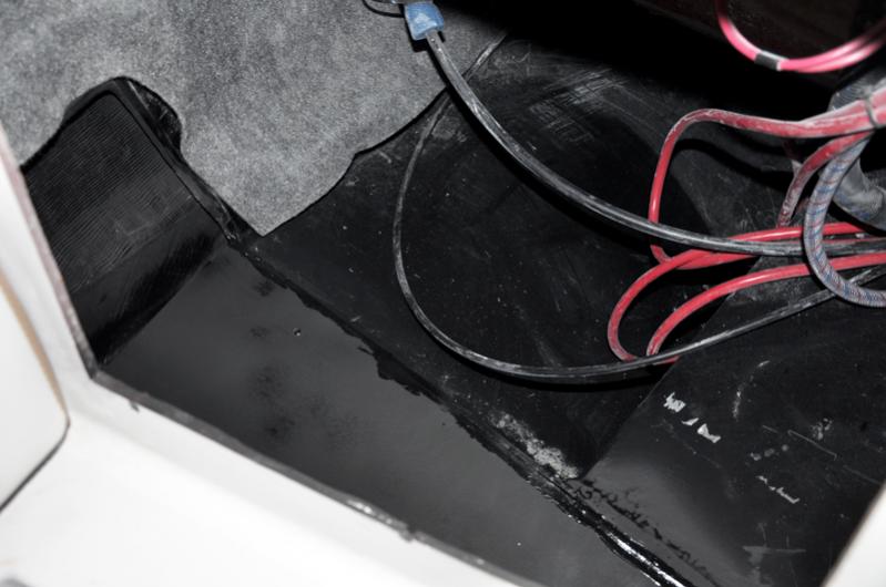

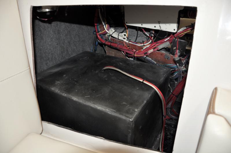

                    But that would give me 2 subs in 2 very different locations. I have the Fi 15" in the factory OEM location, and then this would put another 12" or so under the dash.
                    David comments that when you separate the subs that much you run into real phasing issues, bass quaility deteriorates etc. I havent done it before so I dont have any reference other than what other folks have said about it.
                    Thanks for the share.
                    One question though, how did you get remove that seat back to get under the dash?

                      Just pull on the sets back and it pops off for a access point

                        I'm afraid of cutting out that back part. It looks like it is a structial part. I looked at doing it to my 13 but never did. But after seeing the pictures, I just might have to go it.

                            No it's inside the driver console. If you remove the front seat back you'll see it. It kinda looks like a pickup sub box.
