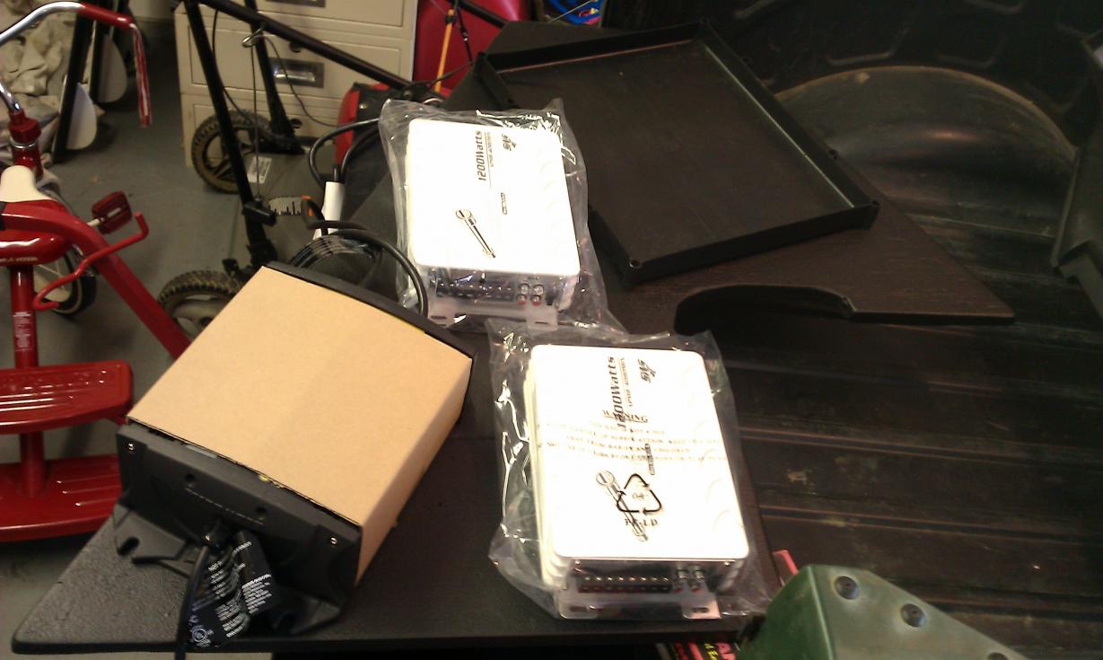

                  This is the setup I have in my closed bow 2001. might give you some more ideas. (2) group 27's hooked together for the stereo. They sit in the battery tray pictured. Built a platform to mount it all to in the bow.
                  Just plug in the onboard battery charger when in the garage and keep's them topped off. I have yet to be able to drain them, even on a 4 day trip blasting the stereo. Keeps it really simple and no worries about alternator or not being able to start engine.
                  I use group 24 battery for starting only.
