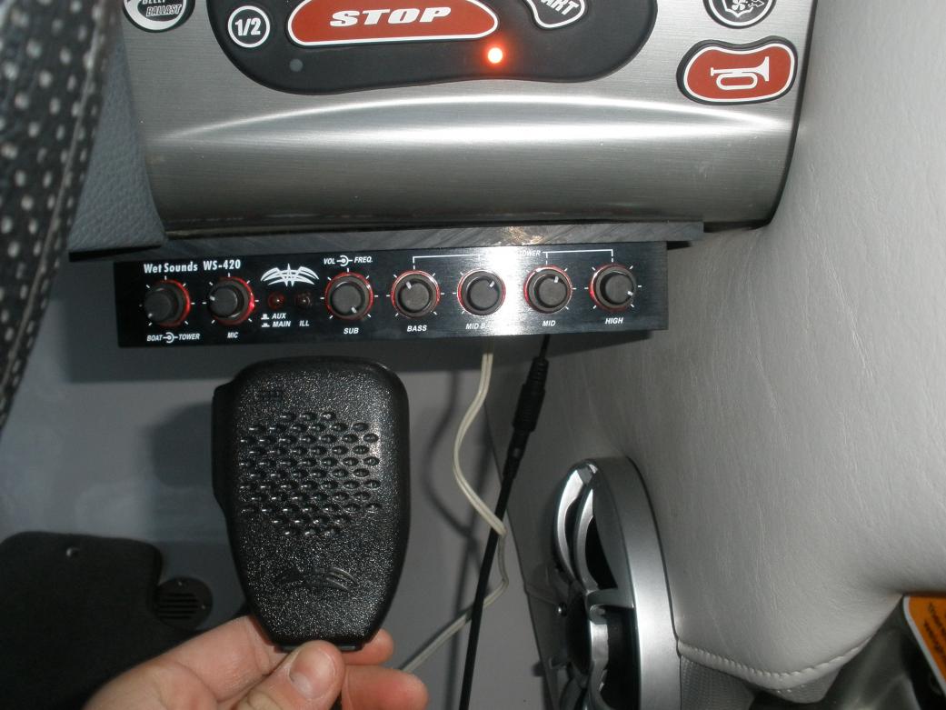

    I have an 05 210 and the previous owner has the ws420 mounted under the dash right side. It's ok but his mount moves abit and I was wondering if any one could post pictures of where they mounted theirs and how they did it
    Here is how mine looks currently

    The method of using heat-formed ABS as an angled adapting bracket or adapting bridge between two available mounting points is completely sound. It may have worked lose. You may need to add rigidity. You may need to level it a bit better. You may need additional attachment points. You may need a rear back brace for stability. The execution probably just needs a little refinement.
    I would place a deeper intermediate panel between the ABS and EQ bracketry so I would have something to strain relief my RCA cables to.

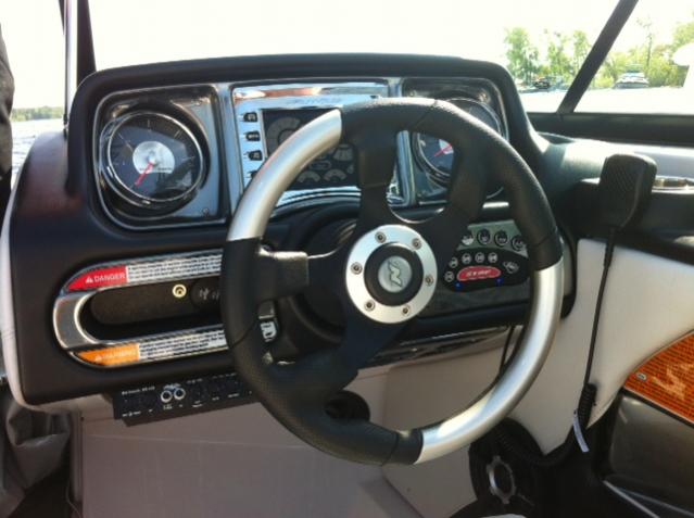

                      I have a 2010 210 here is my WS420.Click image for larger version

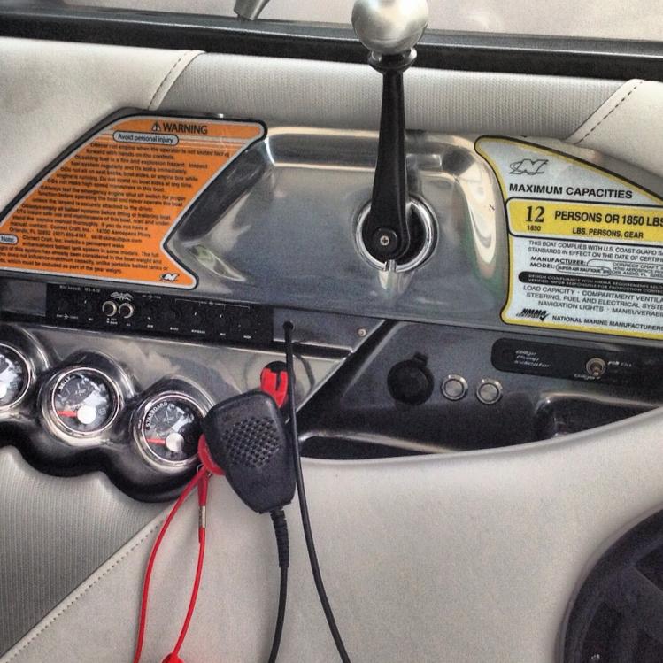

                        Mine is screwed to a piece of plastic that is screwed through the metal. Attached are some photos that might give you some ideas.
ID:	365322Click image for larger version

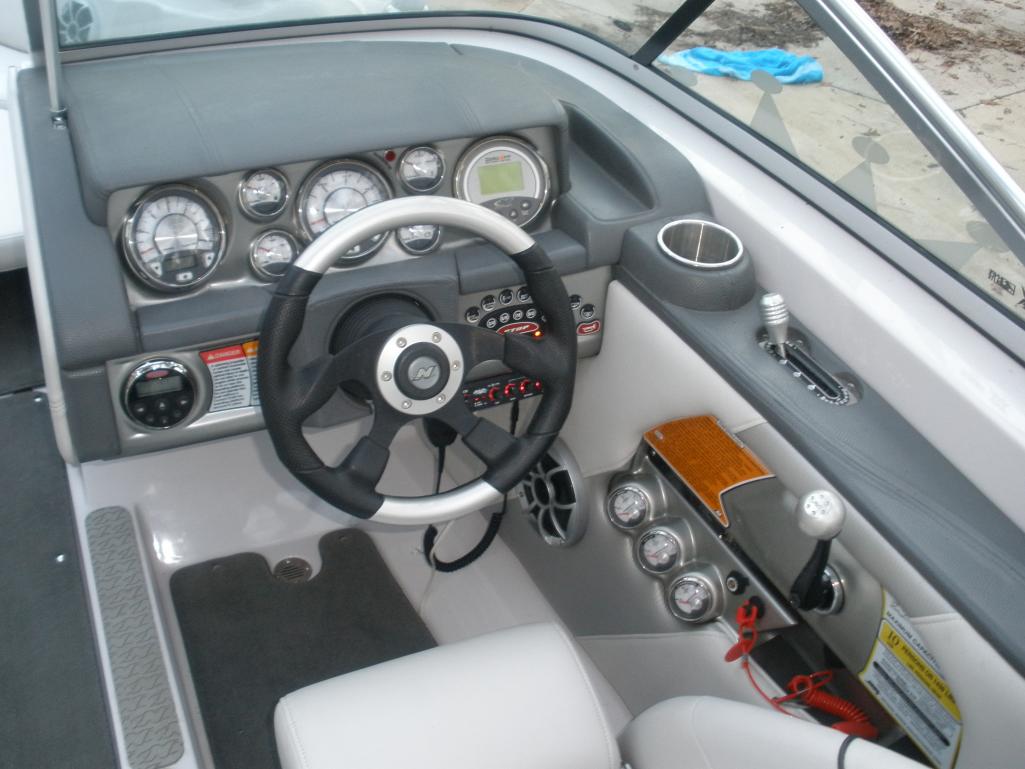

                              One of my many winter projects. I moved this fairly easily, plus it gave me the opportunity to try and quiet down the rattle in that panel.
