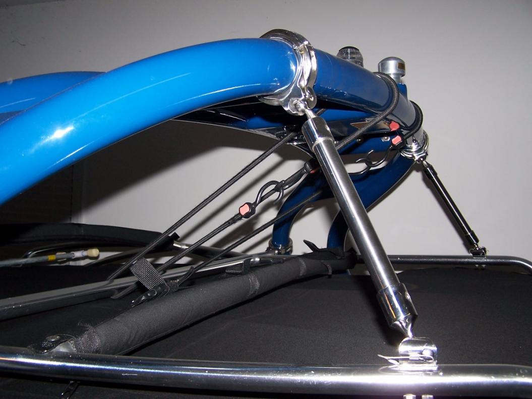

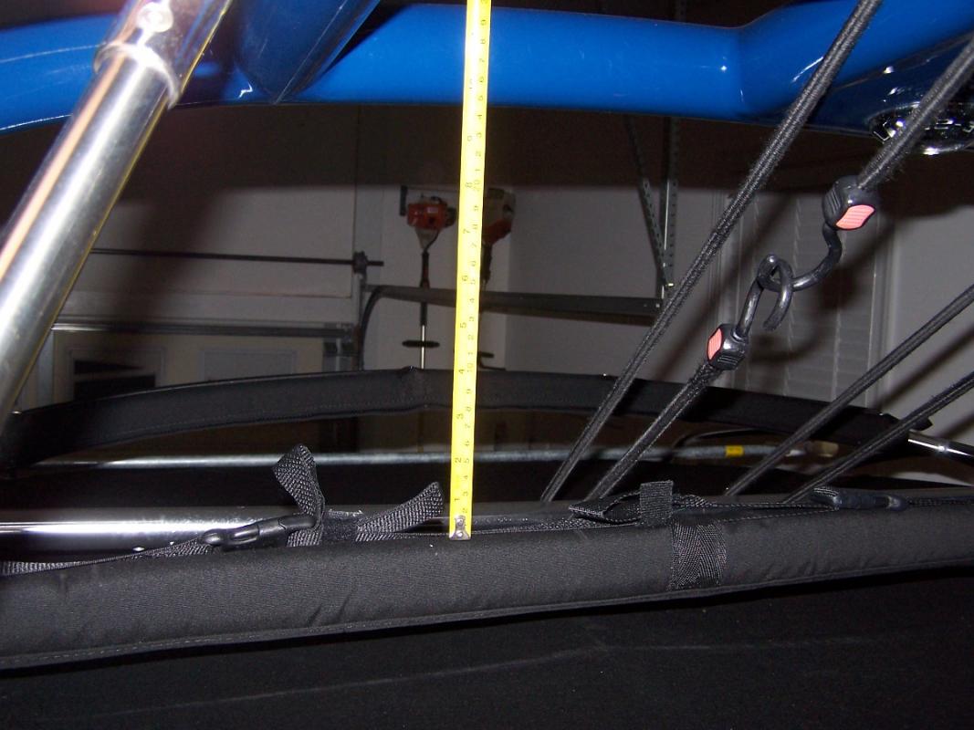

    I don't have the same boat as you, so not sure if this helps...might give you a frame of reference. On mine, there is 9.5" clearance (sorry about the blurred tape measure) between front tower bar and Z5 cross member that coincidentally lies just underneath the tower bar (2011 FCT / Z5 on 200V). However, there is about 13.5" clearance between rear horizontal tower bar and Z5 bimini & frame. Also, I adjusted the rake of my Z5 to be as level as possible...had to do this by rotating the rear link brackets fully down allowing maximum rear link length...provides maximum clearance for stowing gear.
