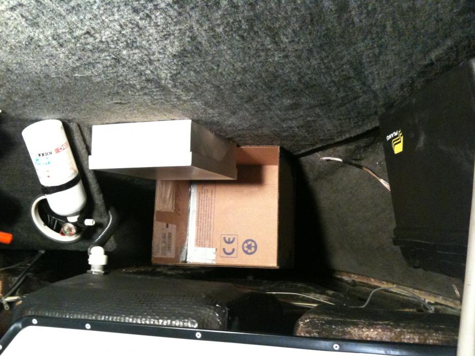

          Thanks for all the great info, you've been a ton of help and I'm going to have more questions once I start the install. There is no way I'll be able to fit a group 29 in the stalk battery location in the floor. In the picture I took I made a mockup of the box Ill be using and the shoe box behind it is where Im going to put the second battery. I should be able to put a group 29 there in one of those protective boxes. Any issues with that location? Is it ok to mix a group 24 lead acid and a 29 lead acid? Would a promariner 120 be a good choice for an onboard charger for this setup? Thanks again.

            I'm putting mine into the floor, similar to what core-rider did in the DIY section. Instead of having them in boxes I'm going to have a hold down frame on them and then build a slightly raised cover to hide all the wiring between the batteries, switches and the VSR. If your box is the size of that cardboard box, your going to have a hard time getting to that and keeping it secured. The hold downs might be worth a look for your project.

                Yep, I was pretty sure it would be a stretch. other then your boat being upside down, I see no issue with location a battery there. No issue at all with using a a group-24 cranking and group-29 deep for your two banks. They are both wet-cell lead acid. A group-29 and a group-24 would be a collective Ah's of about 160, so a 20A 2-bank charger will be perfect.

                  Thanks again MLA. Yeah the only way I can get the boat to fit in my garage is to hang it inverted from the ceiling.

                    I bet it drip drys well

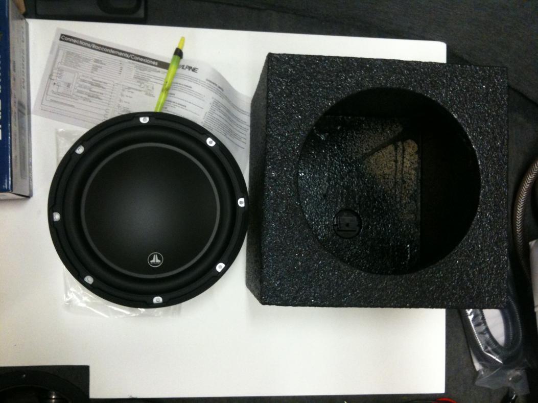

                                Here is my sub set up. JL 10w3 in a small sealed enclosure coated in bedliner. Its tiny and will fit way up in the nose firing forward and be out of the way. Going to be powered by 500 watts from a JL MHD 900/5. I'm going to add some composite spacers underneath to keep it off the floor. Should I throw some polyfill in the enclosure before I install the sub? Any other suggestions? Thanks.
