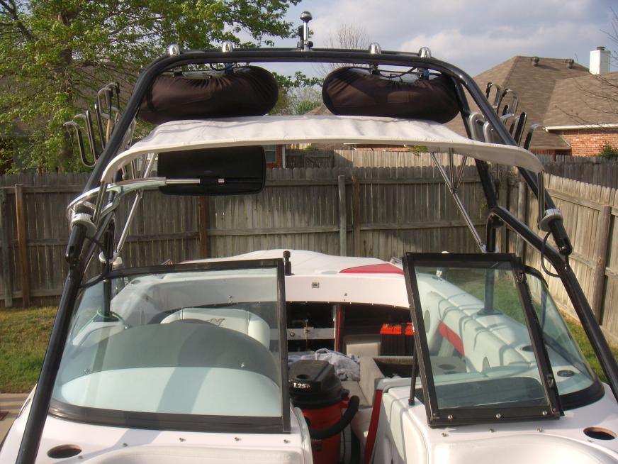

      I'm not sure what FC tower mine is but it looks like the one pictured here. Its a 2003 226 sante. I mounted pro80s under the rear hoop and used a disconnect from a hobby shop. I'll Add pics later but the connectors are gold platted and can handle way more power than my arc audio can put to them. I didnt want to have a connector but it was the only way I could find to get the wire to the rear hoop.

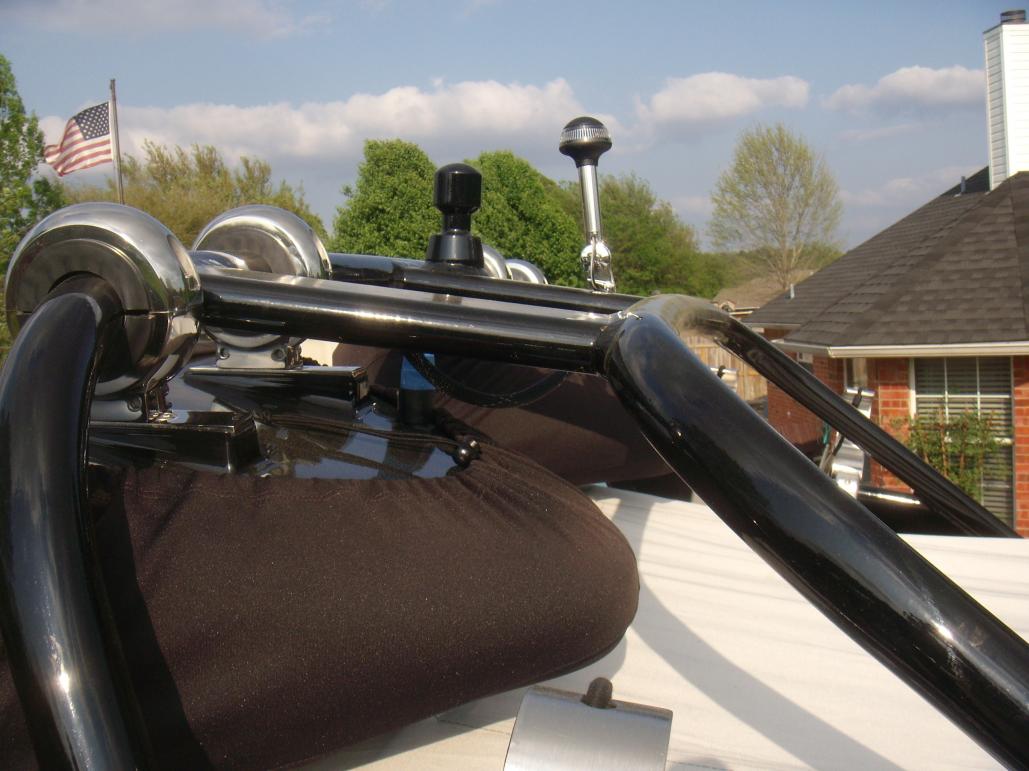

          The port side has the speaker wires in front leg, and starboard side has the wires for the anchor light. Both have sheathing and grommets at each hole.

ID:	364504Went in through the factory hole at front leg of base and then out to rear hoop.

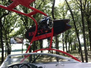

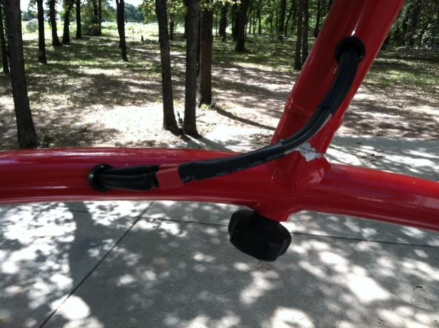

                • 2003 Black SANTE
                These pics are from my tower light install, but tower speakers are done much the same way...
                I drilled a hole through the backing plate, fiberglass, and tower leg mount...
                Ran wires up front leg into front hoop of upper tower...
                I use braided wire sleeving and heat-shrink the ends to keep it from fraying. I also prefer the holes drilled from lower to upper legs on the backside of the tubing instead of the frontside, but either will work. I use plastic grommets at all tubing penetrations.
