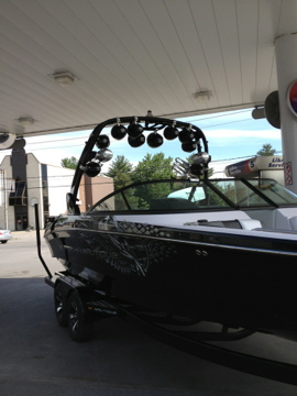

          • julie350
            • May 2012
            • 12
            • mascouche canada
            • G23 550 2013
            • ViSoR
              • Sep 2010
              • 266
              • Montreal, Quebec, Canada
              Sick sick setup, that must be loud! I'm very jealous, the boat is sweet too. I wanna surf with you! lol
              Tu es de quelle région? Moi je suis sur la rive-sud de Mtl.
              2008 SANTE 230
              2005 SAN 210 - Sold
              • Mikeski
                • 2909
                • San Francisco, CA
                • Current 2017 GS22
                Hmmm, I'll be in the Montreal/Drummondville/Mt Tremblant area in a few weeks (July 6-14). Might be worth trading an afternoon of surfing/boarding for some stereo tuning?
