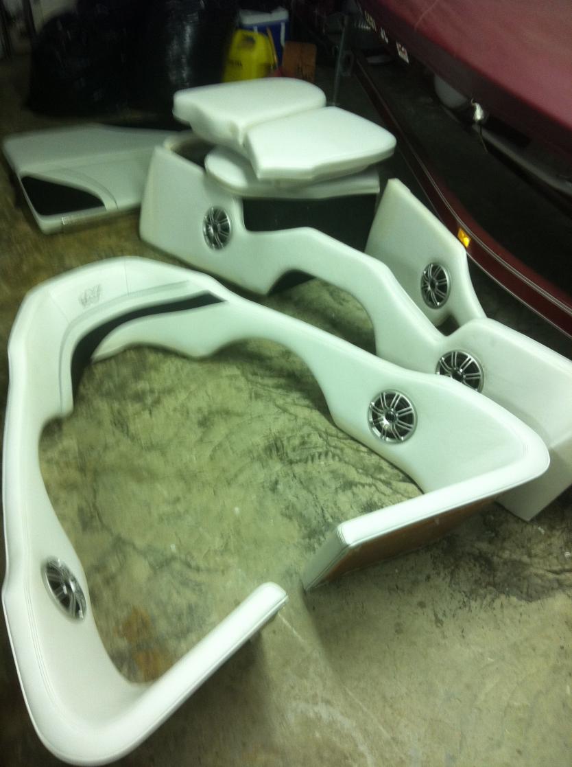

      I have the db651s in my ride. Here is a pic of mine and a link to a guy on WW of how he did his. I followed his advice on this and had no problems.
      http://www.wakeworld.com/MB/Discus/m...tml?1240599090

        I just cut some X's in the grill cloth and popped the speakers in there. They have been going great for 4 years and counting. If I had it to do over again, I would probably put some MDF rings cut in half under the vinyl, but it was easy and has worked well. I relocated the kick panel speaker to a custom built pod located under the throttle and the imaging is much better.
