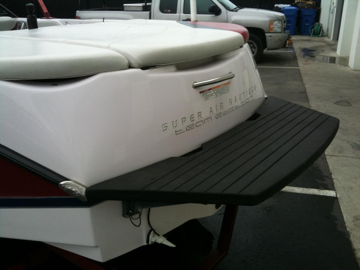

                I think im gonna go with the 3 like your talking about but heres a pic of my teak deck that i had rhino lined that might look sick on your boat since that thing sticks out with the black wrap plus it is maintenance free!!
                • Nauti 210
                  • 82
                  • White Trash, TX
                  • 2002 SANTE
                  I like that a lot and like that it's maintenance free even more! I'm probably going to re-wrap mine next season and go all white on the boat with black accents. Stormtrooper style. Might have to add that deck to the list as well.
