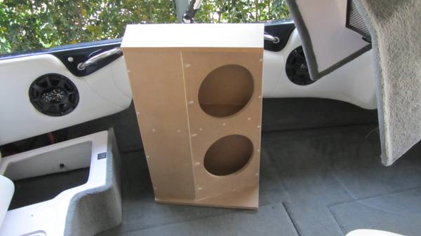

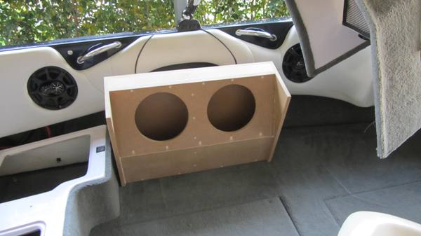

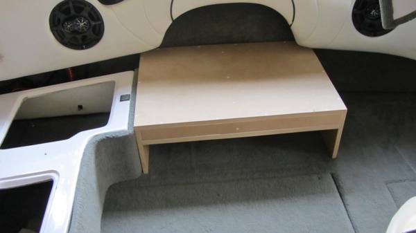

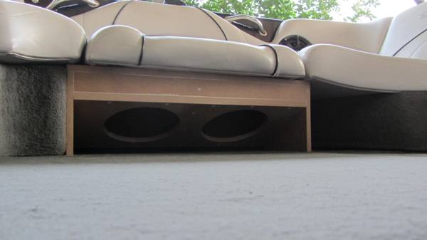

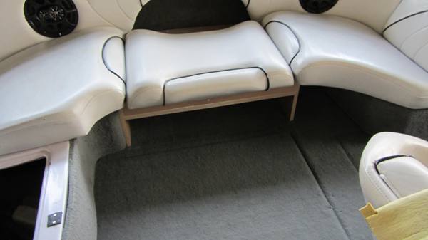

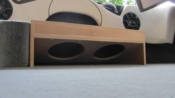

                      Ok so I decided to locate the sub box in place of my port side cooler. I knocked together a "test box" over the weekend.
                      I've used MDF for the test mule. I'll coat in glass & resin to protect it a little, but if it ends up sounding Ok I'll remake one with some water proof material.
                      I've built it for 2 downward firing 10" subs, and to negate the clearance / elevation issue, I've angled the subs. I have 5-6 inches clearance at the front, and an inch or so at the back. I was restricted to the dimensions of the cooler, and I lost a bit with the angled section, but it still works out to around 1ft of air / woofer, which should be OK.
                      I'll post up some pics of the progress.

                              Sub box
                              Here's a couple of pics of where I'm at with the box.
                              I made it with legs to space the bottom of the box up off the floor, but they are slightly too long. I'll trim them up before final fitment.
