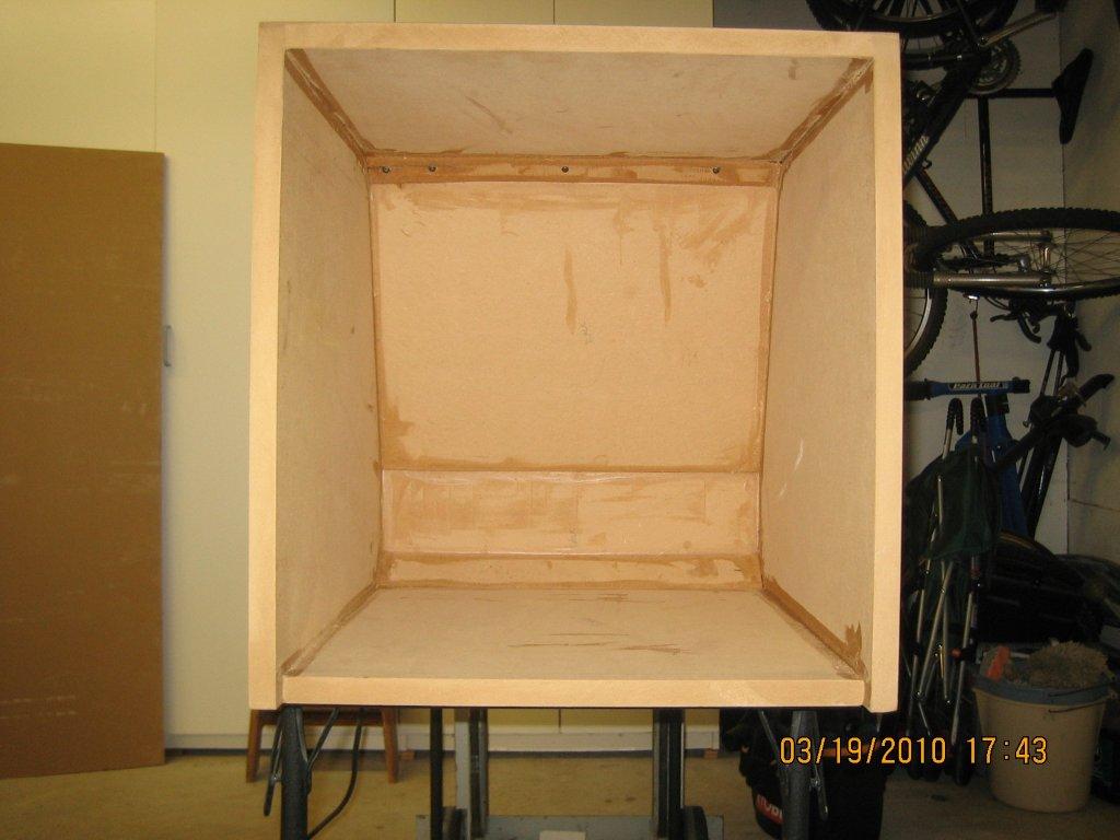

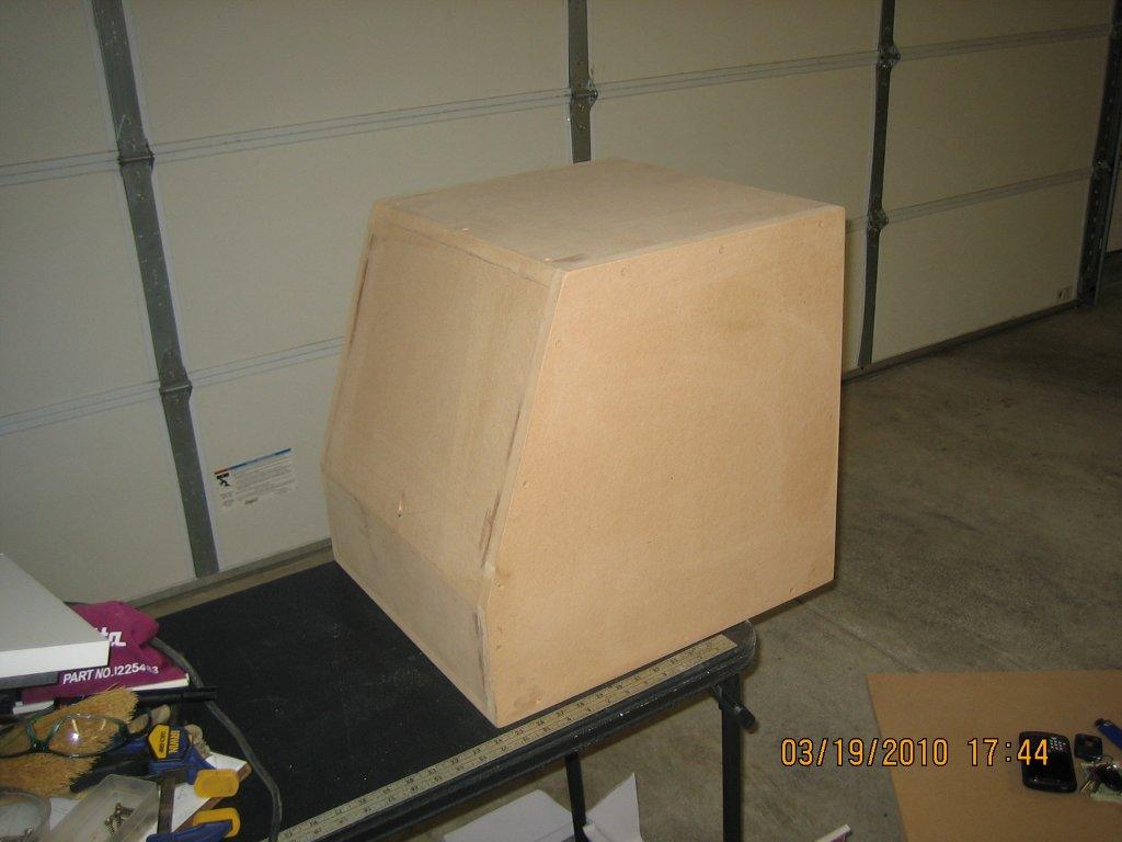

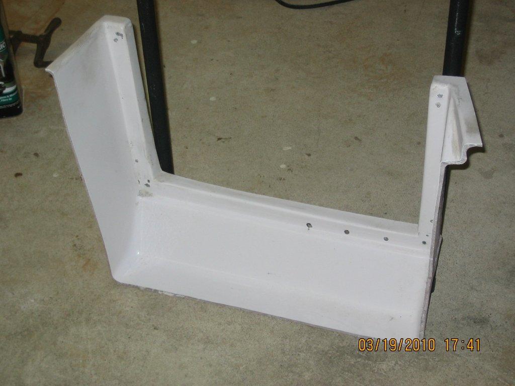

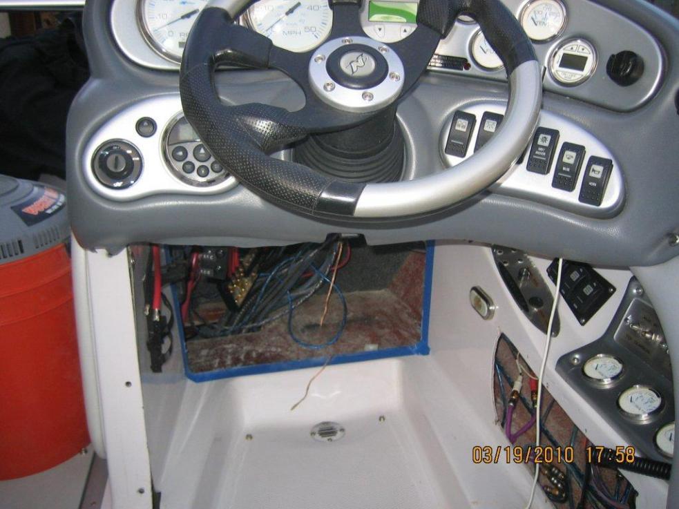

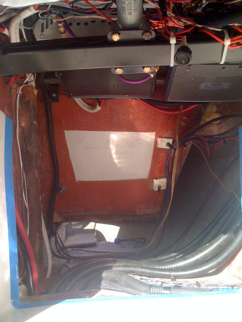

        Too bad about the box. I opened up the footwell of my boat and re-routed all of the cables, hoses, and wires in that space then built a 2 cubic foot slot ported custom box for a Boston SPG555 sub. I am very happy with the result. Unfortunately to get it in I had to pull the dash and steering gear to allow for enough clearance to get it in place. I also had to trim the lower edge of the fiberglass below the steering wheel.
