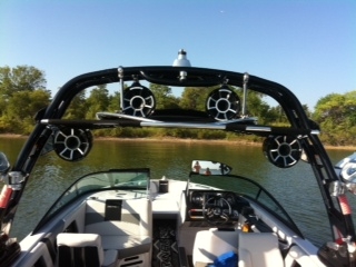

              485s would not work without lowering the Z5 another 3-4 inches. I ended up selling my 485s and getting 4 of the new Wetsounds Rev10s. Put 2 on the tower above the bimini and 2 on the sides, close to where the stock Polk speakers would have went.

                    Wow, you fit the REV 10's under the Z5 on a 230? I went with the REV 8's because it was a gamble to order them without knowing, but if they fit then they'll be my winter upgrade. Got pics of your install?
                    As for mine, I have the fixed mount REV 8's mounted to the tower near the corners. I'll post pics ASAP. Love them but they're not quite as good as my PRO 80's from my last boat so I'm looking hard at either another pair of REV 8's or the 10's. Has anybody mounted an aftermarket speaker the the lower mounts on the tower below the bimini?

Name:	New speakers.JPG

                        can you still put boards on top of the z5 with the 2 rev 10s in the center like that?

                          I can put one board (wake or surf) up there inbetween the two speakers.
                          We didnt get the Z5 for storage(4 boards can go on the racks and there is a ton of storeage in the rear lockers), but because it is way bigger and sits lower for more shade than the stock Roswell or Tower Bimini (I tried for a few months to get Tower Biminis to make me something for a 2011 and got nothing but the runaround from them).

                              Very nice. I'd like to mount another pair of REV 8's or PRO 80's on the lower mounts. Glad to see they fit. Where did you mount the additional amps to run those monsters?
