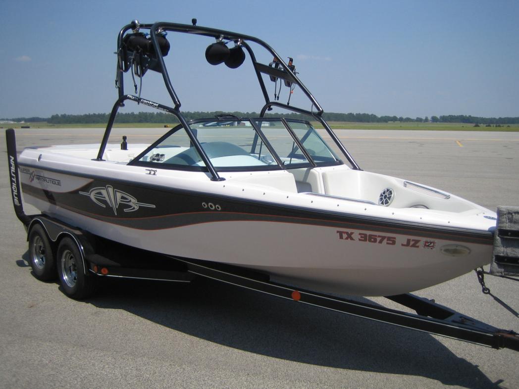

    This is on my 02 SANTE. Just replaced all factory speakers with Wetsounds. They stick out just about the width of the grill, but haven't been an issue in a dozen trips to the lake so far this year.
    Also, for the sub, they mounted it under the helm, behind the kickplate. They had to relocate the fuse panel and shave down the fiberglass footing that the kick plate mounted to. Looks great, sounds awesome, and no loss of space!
    Big props to Tim at Scream Marine in Dallas!!
