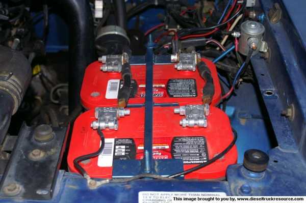

                  Cheap Option
                  If you are running two batts that are identical you can also go with a continuous duty solenoid. When the engine is on it joins the batts. When it is off it separates them. I had this set up in my 90 sport for a decade. I plan on setting it up in my new boat this weekend. Makes it idiot prof as you do not need to worry about remembering to change the switch.
                  Looks like this!
                  http://www.go2marine.com/category.do...=grid&mfrno=84
