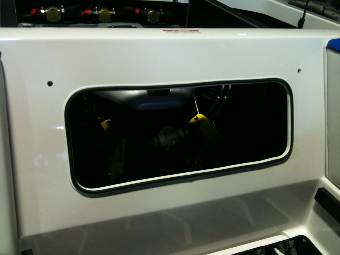

        Here are some pictures of here I was talking about.
        When you remove a trim panel in front of the engine hatch, there is this access hole. I think that if you built a box that fit in here you would get a 12 in there quite easily, at the very least a shallow mount one. Anyone have any feedback?

          Careless,
          I'm not a fan of placing subwoofers at the back of the cockpit. Its fine when you are at rest but the sub amplifier and woofer have to work inordinately hard while you are underway to create equal output.
          Also, I'm wondering if the panel/cushion would remain off and if not how the bass radiation would be vented into the cockpit.

                David, My thought was to leave the panel/cushion off and order another trim skin from the factory which I could put over another fabricated panel and be able to cut holes in. With this fabricated panel I thought I could build an enclosure off the back of it and Maybe even have the sub pointing into the cabin and even put a port beside it? The idea is to have it fairly easily put back to factory spec. So I was just going to leave the factory sub where it is and disconnect it. Run the tower speakers off the factory 4 channel (which currently powers the sub and cabin speakers) Run the cabin speakers off the factory 2 channel (which currently runs the tower speakers) Add a new amp just for the new sub. what do you think?

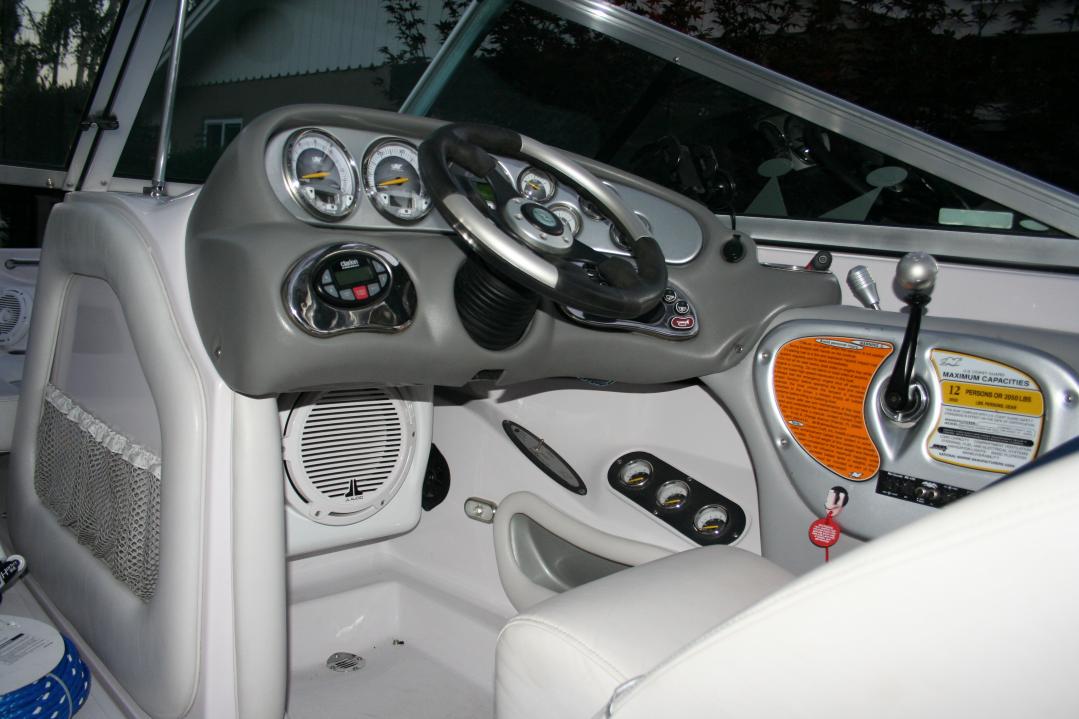

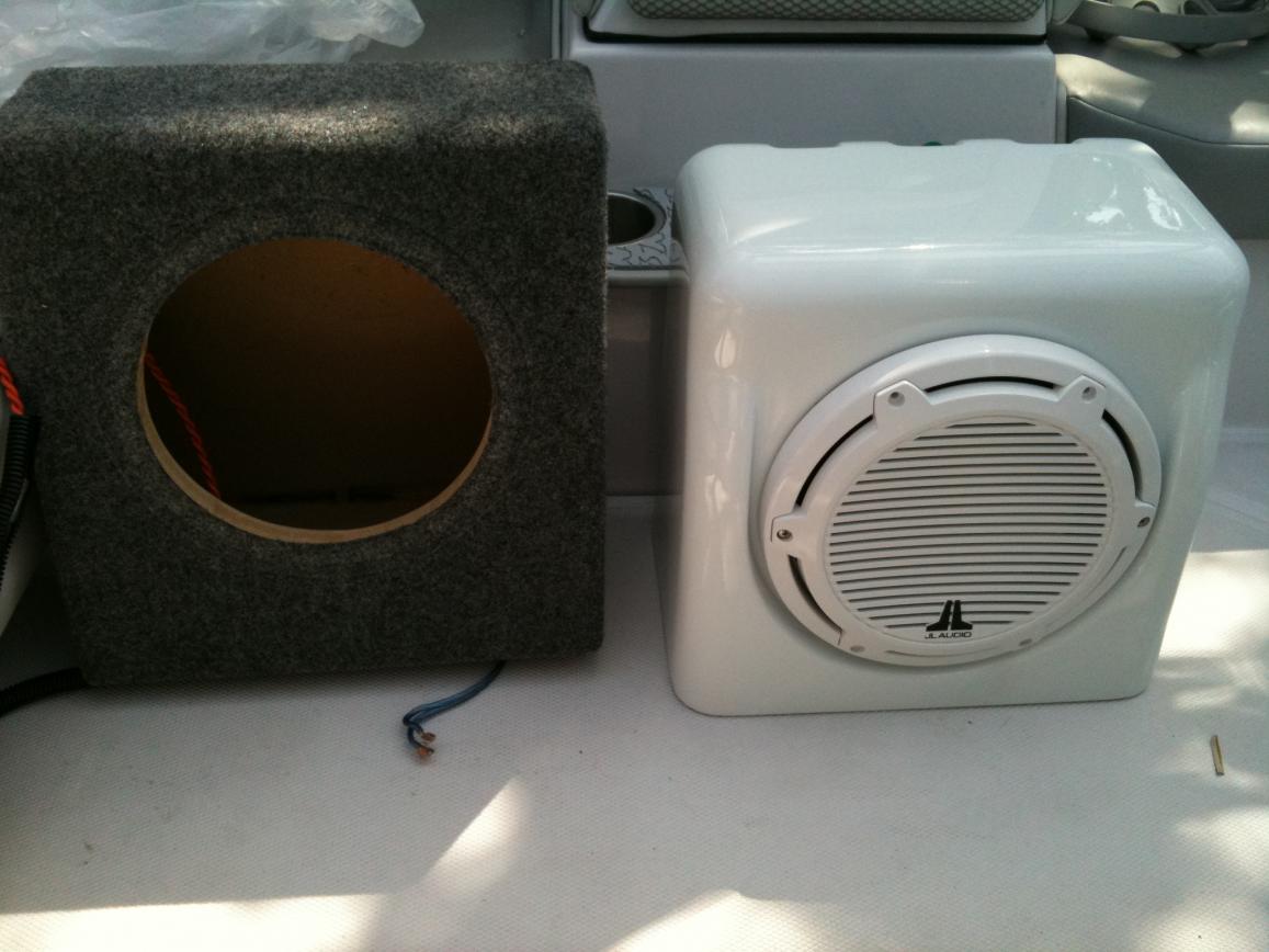

                    Mounted my JL in the JL enclosure right under the dash. I am 6'1" and never hit the thing and it sounds great
                    Not sure if you have room there or not

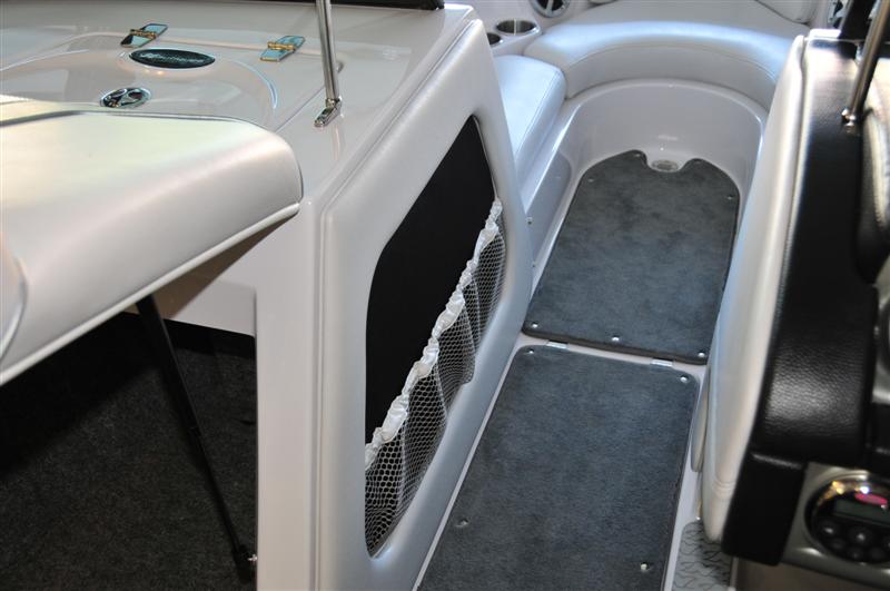

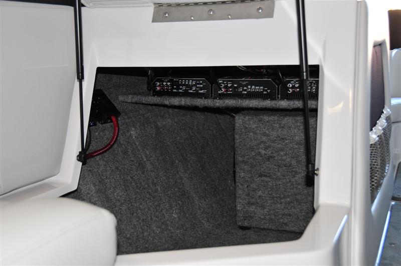

                      I put a sub under the passenger seat...sealed enclosure to the dimensions spec'd by Wetsounds. My recollection is that there's enough room in front of it for the stock cooler, though you can only get the lid partially open. I ditched the stock cooler and went with a soft cooler I picked up at Costco...so room is not a problem under there. I might switch to a larger vented enclosure...I'd still have enough room for a soft cooler, towels, etc.
                      Don't forget to vent the space to the cockpit of the boat. I cut holes on the vertical portion of the passage way to the bow and covered it with speaker cloth so it looks stock.

                        Sjames I dont have room there, plus the boat has to be easily returned to factory spec.
