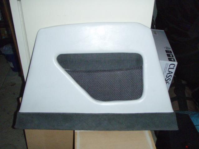

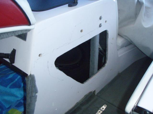

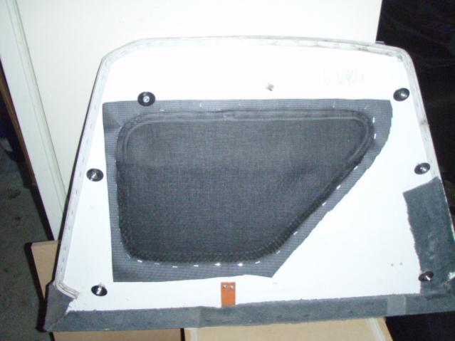

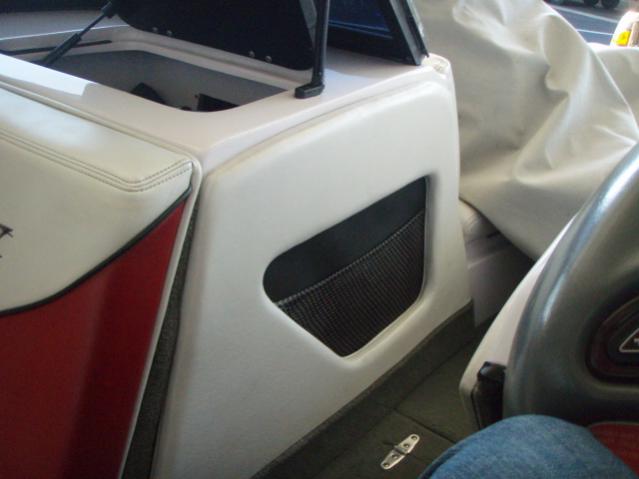

      I dont think it affects the integrity of the wall at all. I left the support bracket in there. I think I used like a 90% screen or something along those lines from Home Depot. You cant even tell that its not factory.

        Looks good Seth.
