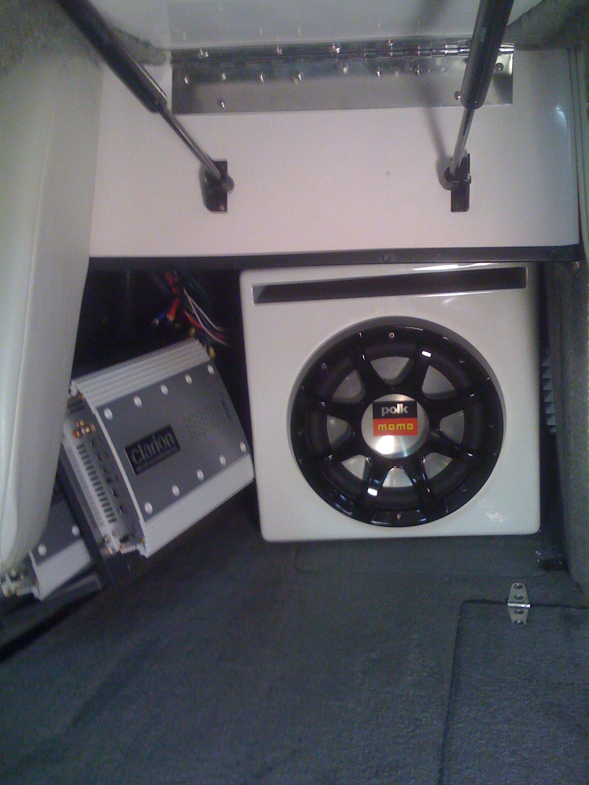

I havent seen one mounted on driver side. Most people mount them under the console/pass seat against the side of the boat: http://planetnautique.com/vb3/attach...6&d=1238467513Current: 2001 Air Nautique GT-40
Yea I was aware that most people mounted them in the area under the observer seat. I was just wondering if there was a somewhat easy way of mounting one on the driver's side mainly to cut down the length of the wire runs. But I guess I'll just mount it under the observers seat.
