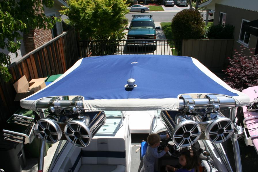

        It's a family boat but I like nice stuff so I want the tower cans to match the JL's in the boat and sound good. The stock Nautique cans have Skylons which are ok but I am hoping the JL's are a step up?

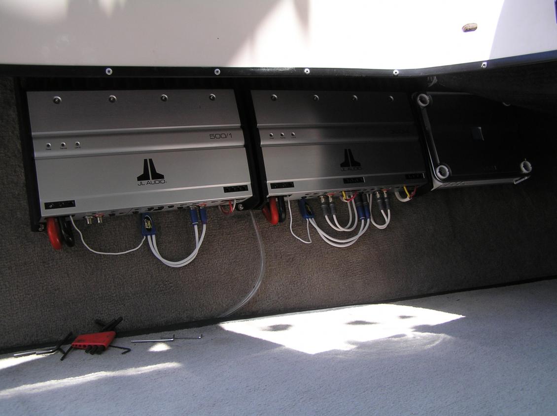

        I also want to mount the amps up higher in the observer locker on a plastic board with standoffs for better airflow and keep them out of any water. Is there a cool mount for that?

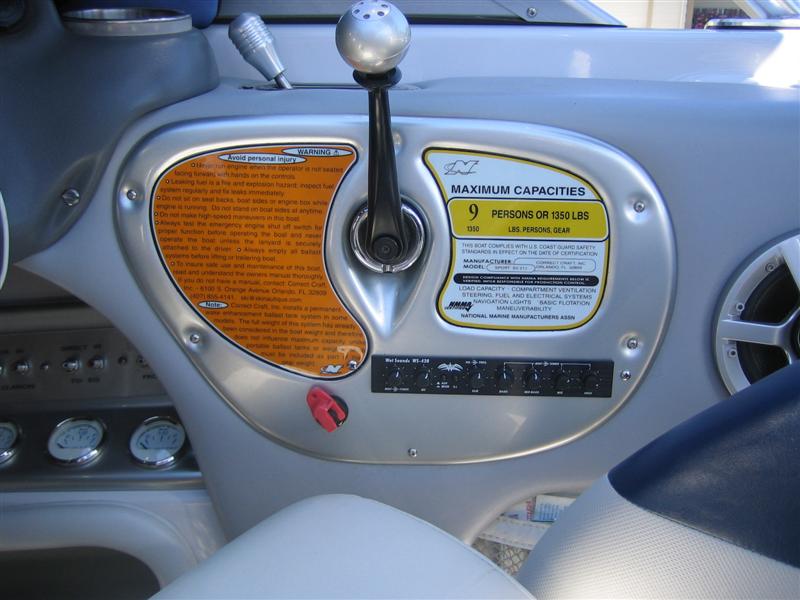

        I also upgraded to the blue top Optimas and got the WS420 today I am trying to figure out if I can mount the WS420 near the throttle through the wall(like this photo of a newer 230 I think)? Or some place other than under the wheel where I will rack my knees on it?

        Some pics of what I have now are attached.

          i have my ws-420 mounted under the left side of the steering wheel and i thought i might hit my knees on it, but they don't even come close at any point. seat up or down. but i'm lazy and didn't want to flush mount it or cut a hole in my boat. ha ha.

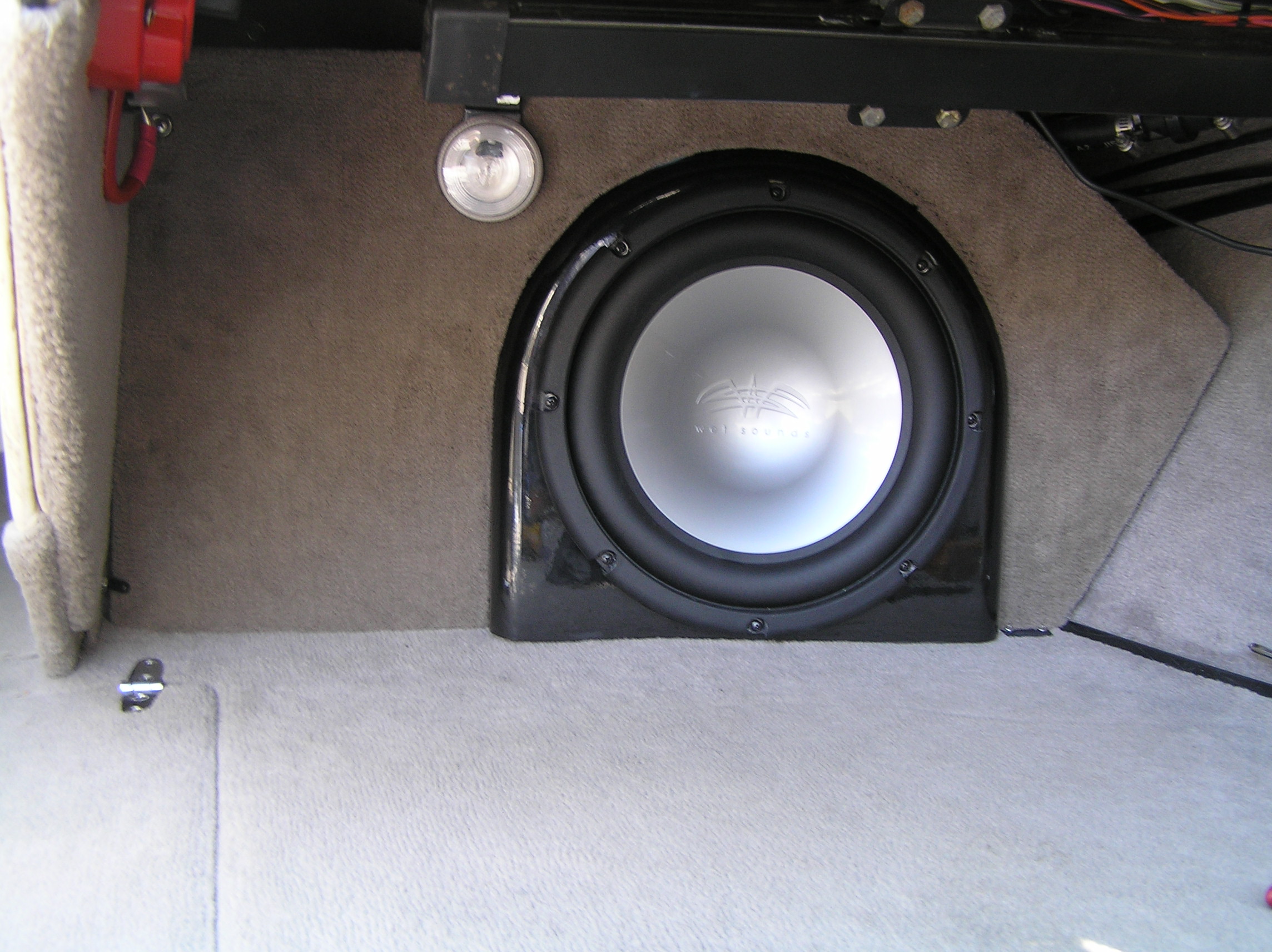

              I just bought a wetsounds XS-12 sub. Going to power witha JL slash 500/1 amp. Going to build a small box for under the gull wing seat where the stock sub was. I only have the tower and boat speakers done so far. The WS420 wired up.

                I wanted to save space as well. I had two 15" subs back in the engine compartment, but new ballast system was more important. Since, storage space is at a premium in my 1999 Super Sport. I put a Wetsounds XS-12 in an audioformz box under my dash. It is powered by a JL Audio Slash 500/1.

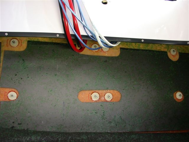

                      sjames: I followed wake_fun's lead and mounted my amps to the hull using clickbond fastners. It is a little more tedious, but I like how they work. Here are some pics.

                              sjames:
                              this link has some pics of a nice location for the WS-420
                              http://planetnautique.com/vb3/showth...cation-Install
                              i actually mounted mine right under the dash on the left side of the steering wheel and it turned out great. had to cut a small square section out of the plastic piece covering the underside of the dash to run the cables. sorry, no pics.
