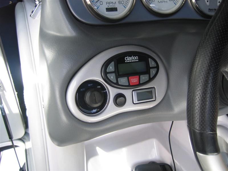

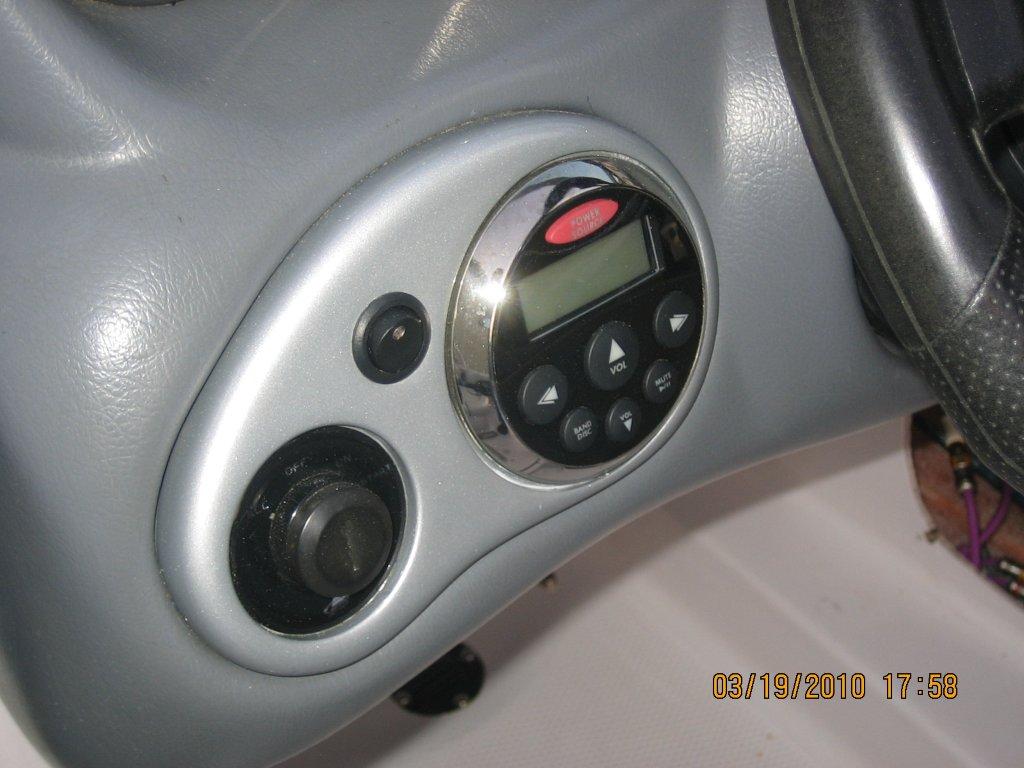

                    Before and After
                    Custom made 3/4" plexiglass plate painted to match the rest of the dash.

                      make that after and before. Seems the site still uploads pictures in reverse order...

                        looks great, is precisely what i had in mind ... apparently no way to get one from the factory, how did you make that one?
